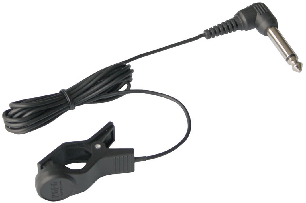

I have a long run of PVC pipe with a leak. It is 4 to 5 feed down in the ground.
It will take a months wages to dig it all up. It is cold and the grass is asleep so I don't see where the leak is by looking for green grass.
I can't find a soft/wet spot.
I can pay a leak detector company $300 to find the leak. I can get a leak detector for $300 that won't work or $1000 that will work.
Most leak detectors are a microphone and a battery powered amplifier. They listen to the sounds in the ground.
I have many audio amplifiers. None with battery power. I don't have 1000 feet of cord.
I have many mid to high end microphones. None are built to sit on the ground.
When I dig a post hole in the ground I can hear the water flowing as soon as the microphone is completely in the hole. I don't want to drill 500 holes.
Any ideas? What type of microphone?

Another possibility would be the use of an accelerometer as a microphone for leak detection.
Accelerometers similar to those used for earthquake detection or another possible is find yourself a cheap guitar pickup and mount it to a section of hacksaw blade. Then get yourself a piece of rebar and drill and tap the rebar so each time you drive it into the ground you can screw the pickup to it. Use a small cheap battery powered amplifier or use a Instrumentation Amplifier and build a simple amp. There was a time when Radio Shack sold basic battery powered amps for a few bucks ready to go. Don't know if they still exist. The accelerometers pictured have 10-32 screw mounts on their bases and the one in the center top has a magnetic base mounted to it.

You have good ideas. I am looking for a microphone that suction cups to a window glass. Radio shack had them years ago. (acoustical guitar mic) I like the idea of mic/accelerometer/guitar pickup on a metal rod. One leak detector uses an accelerometer because they only are looking for low frequency noises. Other detectors are looking for very high frequency sounds. I believe the high frequencies travel through walls but not ground.
Thanks RonV. I have a old automotive PA amplifier. Last week I modified the mic inputs to work with modern microphones. I can hear the water flowing when the MIC is in a small hole in the ground. Right now the amplifier is powered from a battery charger and hundreds of feet of extension cords. I am charging up a small tractor 12 volt battery to power the amp. I need to attach a microphone to a steel rod. Load everything into a child's little red wagon and go for a walk.
