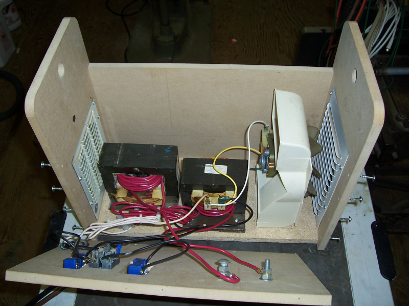

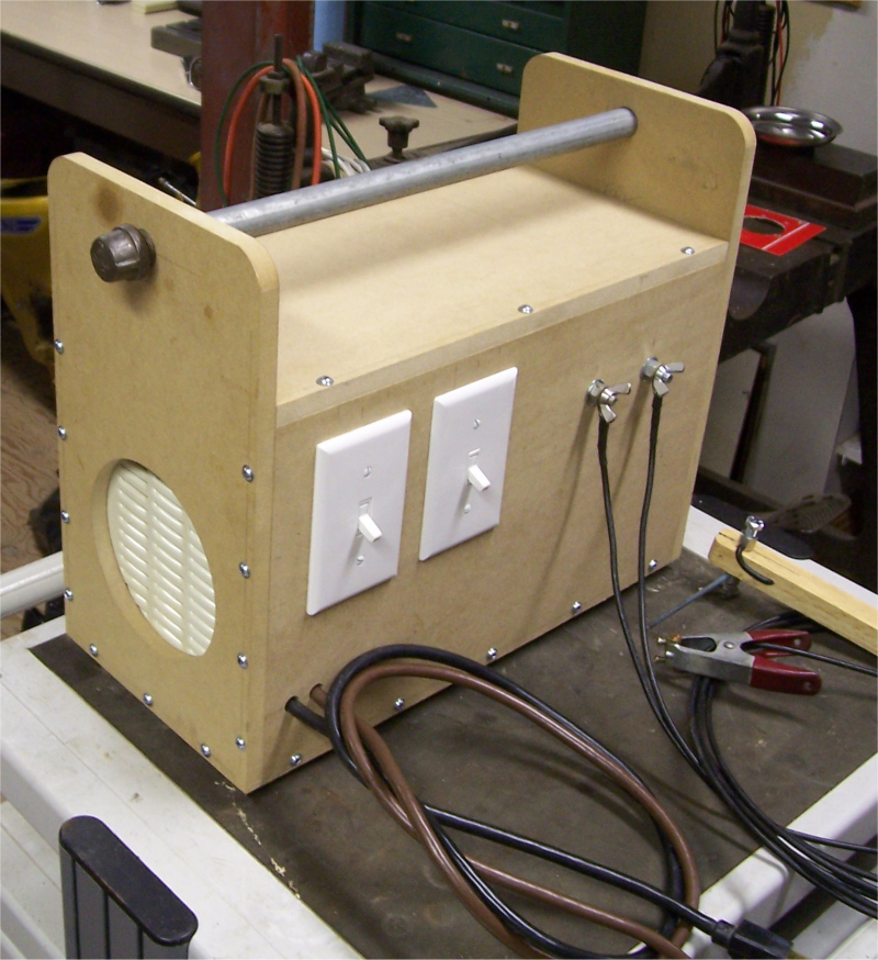

This is borderline as far as electronic is concerned but here it is anyway.

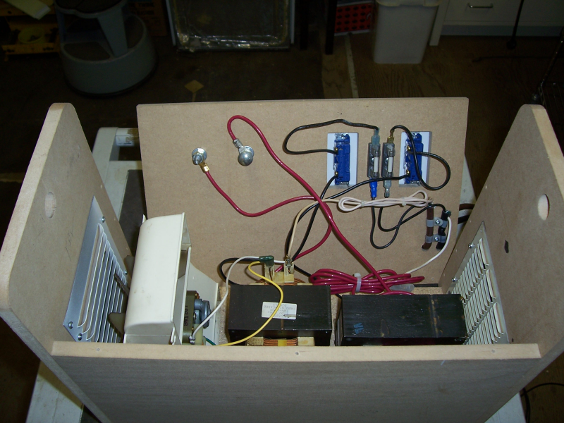

Making it is very easy, just a matter of finding 2 old microwave ovens (the older the better), removing the secondary winding of each transfomer and replacing it with 20 turns of gage 10 stranded wires, wiring these 2 transformers in serie to make the base for the welder. It is very simple.
I plug each transformer in different circuits in the house. Even a strong 20 Amp. circuit is not enough to carry the load of the 2 transformers together.
As for any other welder, using a suitable welding rod is crucial. Preheating the work make the starting easier.

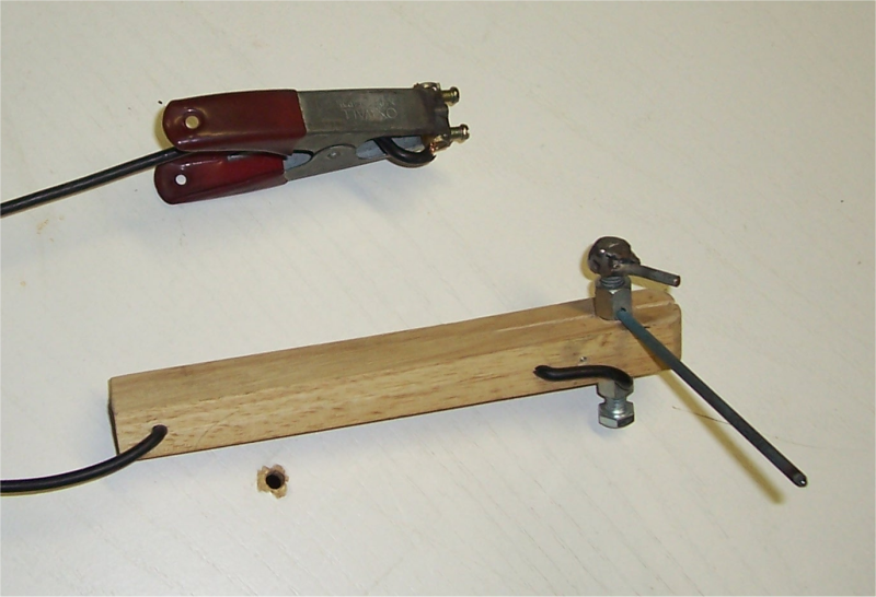

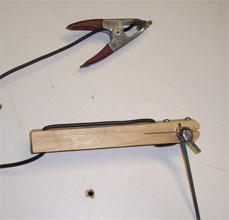

More Pictures!

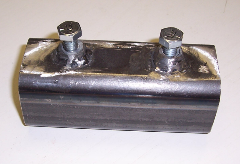

I am not a good welder. This is a skill that has to be learned by practice.

You get a good strong arc?
Yes, I get a good and strong arc. But I consider this thing to be good for small works only. I would not trust it if I had to build a trailer.
I just tested it and the output voltage is 41 volts. It is also outputting 152 Amps when shorted. I don't know how much when it is welding. Probably much less.
In fact I was thinking that the output could be near 40A when welding but maybe it is more then that. I read on the net that it sould be around 70A. I was very surprise to see 152A on my clamp meter when I shorted the 2 leads.

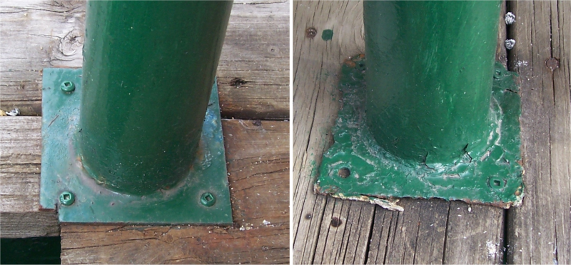

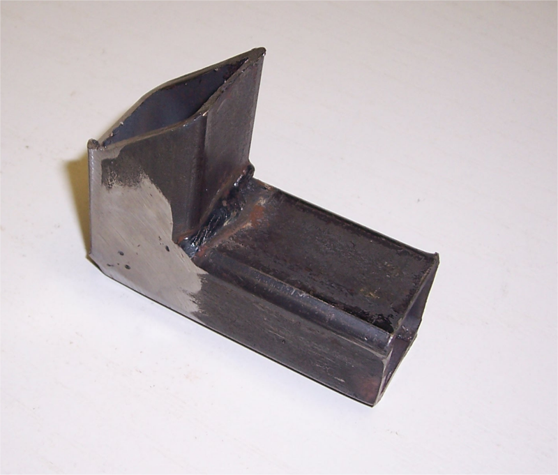

I built this machine last summer. The picture show a work that I have done then: Replacing a steel plate that was rusted. I will have to replace the other one too.
