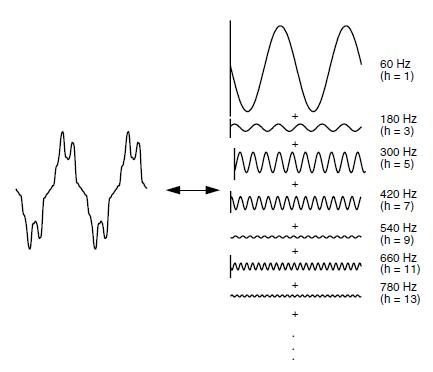

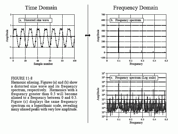

One thing the Fourier transform is very useful for is extracting the relative strength of a signal's harmonics (going from the time to the frequency domain). An audio signal, for example, when run through a spectrum analyzer, results in a display of the harmonics and their strength relative to the fundamental frequency. This is how distortion measurements (like THD%) are made.

When the distorted sin wave is converted into freq. domain the amplitude reaches above 400 ( what that's??) and how freq is calculated of that sample signal...as F=1/t.
If we talk about the the second image, the harmonics at 60hz is called h=1, then freq. at 180 is called 3....that mean as freq. increase the harmonic no. increase.

Concerning harmonics, you have the general idea: the first harmonic is the fundamental (F1), the original frequency. The second harmonic is twice that, the third is three times that, etc. Notice that that illustration only showed odd harmonics (F3/5/7 ...). Probably the result of measuring a push-pull output stage, which doesn't generate any even-order harmonics (F2/4/6 ...).

In first fig. the Sin wave of time domain is converted into freq. domain (the parameter like amplitude and freq. how they are calculated??)

Because of its balanced configuration (two amplifying devices, each amplifying half of each cycle), a push-pull amplifier typically has zero (or close to zero) even-order harmonics in its output, since these tend to be cancelled by the output stage.
Forget amplitude: that's not important here.
Frequency is the number of complete cycles (positive + negative) per second.
Is that what you mean? Concerning how they're calculated, well, that's a function of the Fourier tfransform. Unfortunately, I can't tell you how that works (since I don't know). Perhaps someone else can explain.
