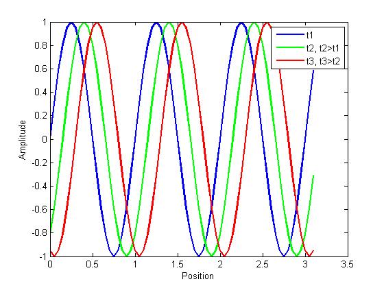

Now to turn to a previous question, I think in this case a picture is worth 1000 words.
The sinusoid is plotted as a function of position against some abstract "amplitude" quantity. Each of the different curves are shown at a different time snapshot and plotted against position. You can see the sinusoid changes position (physical position, like moving in a room) as a function of time. That is there exists some nonzero partial derivative dz/dt, where z is our "position variable." There are three curves plotted each at a different time snapshot such that t1>t2>t3.
This plot shows what I earlier defined as a "wave." A wave is a phenomenon that changes position with respect to time. That to follow the crest of a sinusoidal wave in this particular instance one has to change position as a function of time. As time changes one has to move in position to follow the peak of the sinusoidal wave.
What you seem to be trying to demonstrate is the way a traveling wave, such as you might find in sound, works. But, you are doing so on a wave-by-wave basis rather than on an instant-by-instant basis.
It is an instant-by-instant basis. It is a single wave shown to be propagating (changing position) as a function of time, which if you'll look to my previous post is what a "wave" was defined to be. You asked what I mean by changes position, so I showed you that a "wave" changes position as a function of time. There are not multiple waves in my plot, there is a single wave shown at different times.
Remedial vs. Advanced Topics
I got that it was a single wave that was moving along. My concern is that it clouds the water of how the sound propagates by adding the extra layers of having to conceptualize the integration of the molecule-to-molecule actions into the wave and then, after analyzing the motion of the wave, on some macro level, re-conceptualizing things back to the molecule-by-molecule level where the propagation is actually taking place.
I have no objection to doing all that...but, at a more advanced level than when trying to figure the basic principles of how sound itself propagates.
