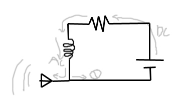

chui
Im trying to understand the nature of a tranmitter.. :shock:
tell me something about this circuit
thnks
I'm afraid that circuit will not work for you.
If you are lucky, you could probably transmit a maximum of 12 inches with a 9V battery.
Transmitters have oscillators. Your circuit does not show one. You need capacitors. An active device (transistors as the most common one) would help too.
there are ultra simple transmitters on the net. Look on discovercircuits.com
That is called a tank circuit. What basically happens is that current bounces back and forth between that capacitor and inductor. The current gets stored in the capacitor's electric field, then it leaves the capacitor and gets stored in the inductor's magnetic field.
Theoretically, this process could go on infinitely. Unfortunately, that resistor represents losses in the system, whether they be inductive losses (the magnetic energy transfers to other metal objects around it), resistive losses (the resistance of the conductor), etc.
The number of times that it bounces back and forth per second is the frequency: If it bounces back and forth 100,000,000 times per second, it's frequency is 100MHZ.
Mstecha is right though, that is not a transmitter.

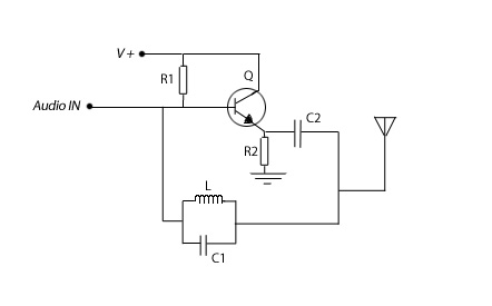

Sorry, I was stupied,
I hope this one is closer:
Will it transmit the Audio Signal?
Hi Chui,
I don't think your circuit will oscillate. An oscillator needs a gain of more than one. Your emitter-follower has a gain slightly less than one.
Why not use a standard Colpitts or Hartley RF oscillator circuit?
I found many circuit,
but the thing is that I want to understand them.
Aoudioguru, What do you mean by saying
"An oscillator needs a gain of more than one"
I thight the Emitter only needs to supply voltage to the transistor.
Please explain about it..
Hi Chui,
An oscillator doesn't work with majic, it works by feeding the output of an amplifier back to its input with the proper phase for the feedback to be positive, and enough level for oscillation to start and continue.
If the amplifier is an emitter-follower with a gain of slightly less than one, there isn't enough feedback level to start oscillation and not enough to maintain oscillation. With some gain in the oscillator's amplifier, at the beginning the circuit's noise is amplified, then fed back at a higher level to the input at the frequency of the tuned circuit and keeps on amplifying and feeding back until the output is at full level with a signal without much noise.
I don't analyse standard circuits, I just use them. If you want to analyse them then do a Google search for RF Oscillator and you will find many tutorials. :)
A grandfather clock is a mechanical example of an oscillator.
A pendulum on its own oscillates if given a push, but it is a damped oscillation, ie. it gradually looses energy and eventually stops swinging.
So it needs an energy source such as a weight hanging from a chain and a mechanism to give the pendulum a kick at the right moment and of sufficient energy to maintain its kinetic energy. This is positive feedback.
As Audioguru said, an emitter follower has a voltage gain of slightly less than one. So it cannot keep the tuned circuit oscillating. So the TC gradually looses energy and stops, ie. it is a damped oscillation.
To keep it oscillating, you need a loop gain of one so that the energy lost per cycle is exactly replaced from the energy source.
If the loop gain is greater than one, it will oscillate, but the waveform will be more like a square wave rather than sineusoidal.
Len

It should be mentioned that the Colpitts oscillator uses an emitter follower. The voltage gain is provided by driving a "tap" on the tank circuit with the emitter. The emitter follower provides current (and power) gain, allowing oscillation.
