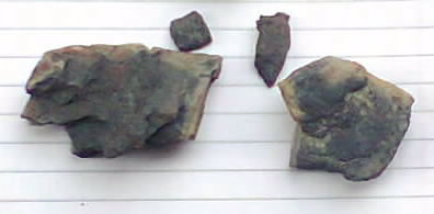

Wow it is amazing! I collected few black stones (brunt out coals?) from old railroad tracks. I tested conductivity through this materials and measured on multimeter, it is conducting current fully! Then I think it can be used as a AM rectifier like Cat's Whisker's radio :)

To work as a rectifier it has to only conduct current in one direction, the point of the 'cats whisker' is to search the 'stone' for a spot that works.
Rubble off a railway track is unlikely to be coke, you need to process coal in a specific way to produce coke.
