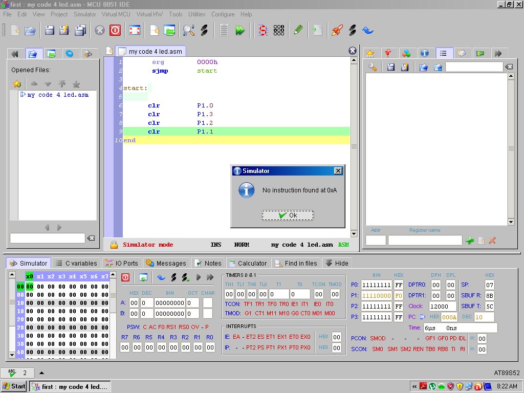

Hi, plz tell me what is wrong in the code????
but the LEDs are working....View attachment 72796
Nothing!! The program is ended..
If you need repetition, then you need to include a super loop.

if I write these program into the micro, then will it work?(it is working in the micro)
what will be frequency of the LED's to turn on and off????
Oooh!! Too fast...
The 8051 normally runs with a 12mhz clock.... 12 cycles per instruction... 9 instructons + 2 for the jump... 11 cycles or 11μS per loop... The LED's will appear to be doing nothing, as they are off more than on...
The human eye will need 100mS to see the LED transitions... ( 10 pulses per second )
You will need to write a delay routine ( one in the first example we did ) to slow the action a bit...
