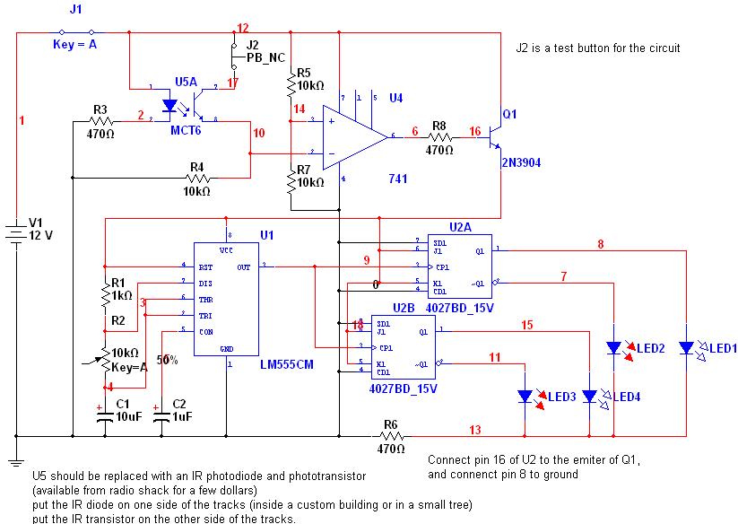

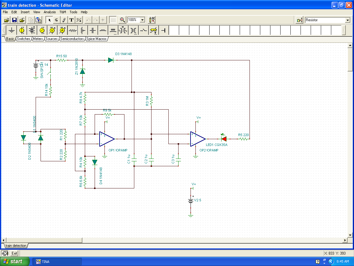

Trying the second link you posted (block detection) in TINA. working out why it does not work right. think I have the wiring wrong.
don't know why a resistor is not used for hysteresis? (avoids the circuit from jumping on and off erractically. either on or off)
something not right|??

I'm using a croc clip on the components. Read that somewhere else too. I've got some 60/40 alloy solder. Not sure of gauge but it works fine when the heat melts it. I use that with 'Regular Soldering Paste', lead and acid free. I really do think it's just the soldering iron not getting hot enough. It's an ancient one with cheap metal tips, don't appear to be copper or brass with whatever plating, just solid metal.
I have to say I like the detector circuit on the NMRA site. Not sure how to replcate it in TINA tho' as it needs the track and loco to be simulated. Seems a lot simpler than the original one I was looking at too.
