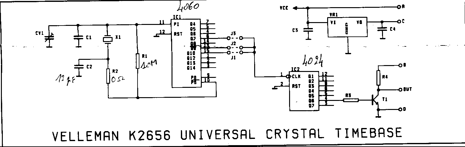

Attached a universal Xtal timebase circuit from Velleman.
With a 3.2768MHz Xtal you have 50, 100 and 400Hz available at the jumpers J1, J2 and J3.
You can of course calculate all other frequencies as well
Using another Xtal can even give you a 1Hz pulse.
I leave the math to you

If you havn't figured out the use of the Reset/Sync button, its for when you want to sync the divider when the 'master' clock second hand is at top dead centre. When your master second hand is nearing '0secs' press and hold the Reset button, release when the second hand hits '0'.... OK?
Hi mcs51mc,
The OP is asking for a 30sec divider that driven with 1sec pulses from a master pendulum house clock, not a xtal reference source.
Eric

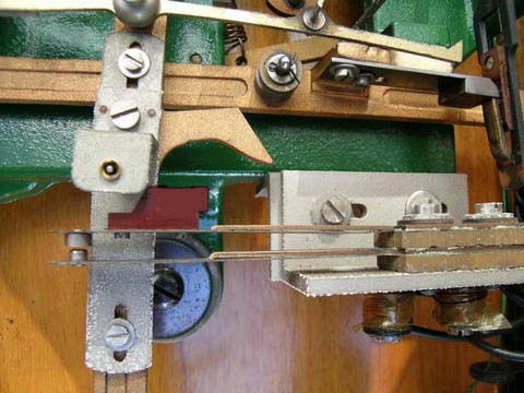

The trigger I have not yet decided on how best this will work for me but the voltage I am free to do whatever will work best for the circuit as the turret clock is completely free of any electrics.
Don't know if to add sensors at the bottom of the pendulum swing or leaf/reed contacts at top middle or bottom any will do.Don't know if I am to make a feature of the contacts or make them discrete. My inital thoughts are to make them bold and large to make a feature as is quite a nice clock as well (double three legged gravity single train Pott's of Leeds, if your interested ?). Are there limitations with the circuit?

I would avoid any 'mechanical' device for getting the pendulum swing as it could upset the swing time.
Have you considered optical emitters/sensors, pendulum swinging thru the light path?

I have considered optical as is a sound solution but I am also thinking along the lines of many already established methods used in many master clocks.Gent used leaf contacts where the pendulum swings from left to right closing the contact on the way these were placed midway down the pendulums length. (see pic)
Also using a set of contact set at the top of the pendulum with arms coming out closing the contacts on each swing as in GPO. masters.
Think would take your advice and would go with optotransistor and LED. to be sure of no interferance.Do you have a little schema to add on to the timing circuit? unless you have any other better solutions.
