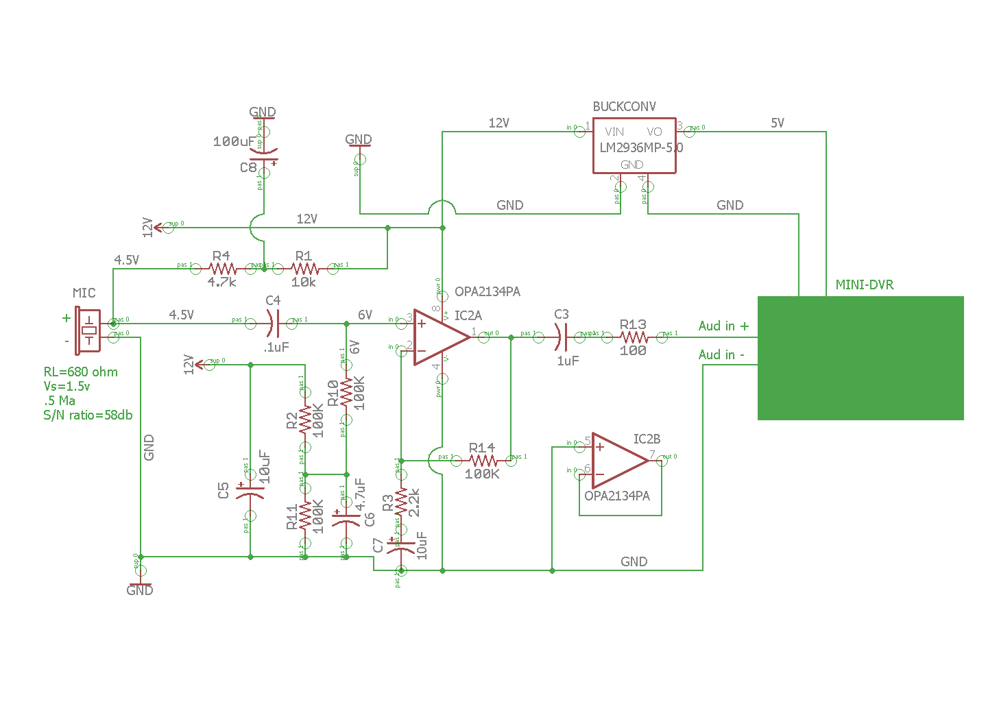

Update... I have a 9v battery going to the DVR (regulated to 5v). I have a separate 12v supply to my preamp & mic. I get perfect audio recorded to the DVR. The preamp circuit is working great! However, I then connected my cctv board camera and monitor to the mix to add video, powered by the same 12v battery and got a noticeable hiss caused by the small 5" led monitor and a loud buzz caused by the camera. I then powered the camera and monitor with another 12v supply and got great audio and video recorded to the DVR. I need to get some wildlife audio/video recorded for a website over the next few days, so next week I will be troubleshooting to see if and how I can power the mic/sound circuit, DVR, monitor and camera all from one 12v, 7AH battery source.
Have you tried to filter the mic supply as AG said in a message #67 ?
Make the supply resistor R12 of series connected 10k and 4k7 resistors and put 100uF from their connection point to ground.

I need the resistor as a pull down so the electret can perform it's function?
No. The resistor is the load of the junction field effect transistor (Jfet) inside the electret mic and it feeds positive voltage and current to the Jfet. The Jfet in an electret mic uses about 0.5mA and is an impedance converter that converts the extremely high impedance of the "condenser" part of the electret mic to a usable lower output impedance. The electret material permanently stores 48VDC so that the condenser part of the mic works as a capacitive voltage divider that changes its extremely high impedance output voltage as the audio vibrates the diaphragm closer and farther from a fixed part of the capacitive voltage divider.

I have added the camera and monitor to my schematic, along with the mic filter. The DVR gets 12v stepped down to 5v. The mic & sound circuit gets 12v with the mic itself getting approx 4.5v. The cctv camera and monitor get the same 12v.
So everything is powered by the same 12v - 7AH lead acid or AGM battery. How does this look?
I am confused when you say "Aud in -" on the mini-DVR instead of saying "audio in ground".
