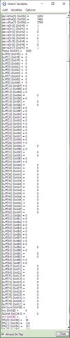

Will have a look tomorrow, 10pm here and school tomorrow. I'll change the bits that need changing and post a new file with the tabs as I find that much easier to follow.
Str is a string variable and you cannot index it like a byte array. So str(i) is not a valid string function. One should use “midstr(str,i,1)“ to extract single characters to a byte.
PS: i=1 is the first character, i cannot be zero
Here's an old example of [ midstr ] that may help. I can see errors etc in it, but if it helps, just use it as a guide?
P.S. Check STR as STRING, as it could have been me that set it to STRING, not sure.
C
I tried the ALL CODE. I changed a few minor lines, so it compiles, and this CODE fills the FIFO() buffer with [ "$test srtingw" ] ok.
If this is true then the mid() isn't needed as the str(n) worked as expected. Can you confirm this? It also means that the first character of a sting is zero and not one. Maybe mid is just another way to access it.
Hi M,
Yes, ALL produces both strings, see top of image and bottom.
From memory:
I think [ midstr ] gets characters from a message like [ $abcdef ] and the BUFF can be used by e,g, [ X = BUFF(1) ]
C
I did a quick test of STR as a string, and indexing it as STR(0), STR(1), etc. It seems to work, provided you do not let the index counter go past the string size. By default, strings are defined as 16 bytes in length no matter how much of the 16 bytes you use. If you define maximum string length longer, then you can use longer strings and "byte array index access" seems to work in this particular compiler. However, if the index goes past the string length, it will continue to return values of whatever is stored in the next variable storage location. Other than a possible compiler warning for a fixed loop counter, there are no checks at runtime to validate that the STR index pointer is valid.
On the other hand, the ASC(MIDSTR(STR,x,1)) function will also ignore an invalid index "x", but always seems to return a zero if trying to access beyond the string storage boundary.
