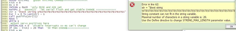

Add GPS/PARSE to 8xSERVO-MOTOR CODE in Oshonsoft
Compiler rejects the longer str= statement, stating that it is too long and one has to define the STRING_MAX_LENGTH to a larger value. It just won't compile...
Hi S,
True!
C
What happens if you extend it programatically?
I.E.
for i=1 to 20
    str=str&"A"
next i
What does it return for len(str) then?
Not that it matters, I'm just curious.
Edit, I don't know how to concatenate strings.
The runtime just seems to ignore going over bounds for strings. It does not overflow to the next storage location. The LEN function returns the maximum length as defined as maximum string length.
So, in your example, with default string length at 16, it fills the string with "A" 16 times and that is all. LEN(str) returns 16. It seems there are some safeguards in place in the runtime code to prevent string boundary overflow.
