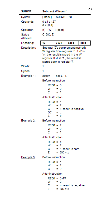

So if the result of the equation is negative, the carry flag is clear, but if the result is zero or positive, it is set?
I will repost that image for SUBWF, its all clearly explained.
