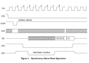

FLASH BURST MODE TIMING
FLASH Burst Timing
FLASH Burst Timing
S29WS256N Flash memory device operating with an 80 MHz clock. At this frequency, the Flash device needs to be configured to insert seven wait states. RDY goes HIGH and DQ becomes valid at the seventh clock cycle. The system sets the starting address by asserting AVD# LOW. In addition, RDY becomes active when AVD# is asserted. RDY goes LOW when OE# is asserted LOW and remains LOW for the pre-programmed number of wait states. As long as RDY is LOW the data on DQ [15:0] is not valid. When RDY goes HIGH, the data word is presentedon DQ [15:0] and the internal read address is incremented on each active clock edge.
A sequence is initiated by the Address Valid signal (AVD#) going LOW and latching the starting address on either the next rising clock edge or the rising edge of AVD#. The Flash device automatically increments the address internally on each clock edge. The initial access time in a sequence is the same as the asynchronous access time (tACC). The data following initial word access is accessed on each clock edge, up to the limit of the burst access time (tBACC).
