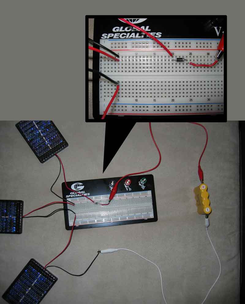

I have 3 Solar Cells connected in series the + is attached to a diode and the diode is connected to the + of the Nicd battery, the - of the solar cell is connected to the - of the battery (see attached photo to see what I did.)
Can someone tell me if I have attached the battery the correct way to the solar cells for charging.

Your wiring is correct and the battery should charge if the solar panels can supply a total of 6.3V at 60mA.

The Cells each are 2V at 200mA, considering they are connected in series of 3 does this mean they are supplying 6V at 600mA ?
Would you know what my NiCd should read once fully charged ?
If I look at 4 AA batteries they are about 6V and 1.500A. I'm not sure about how to read the Amps on my multimeter, I think it is telling me 1.5A. Could this be correct ?
Should these 4 AA NiCd batteries once fully charged read roughly the same Amp as 4 AA Duracell ?
Of course not. Voltages add in series, currents add in parallel. It will be 6V at 200mA at noon on the equator on a bright sunny day with the solar cells pointing directly at the sun. The voltage and current will be less in all other conditions so the Ni-Cads might not fully charge.
My old Ni-Cads were 600mA/hr and measured 1.45V each when fully charged and still on the charger. My new 2500mA/hr Ni-MH cells last more than 4 times longer.
You are not supposed to short a battery with a multimeter. You are only measuring how much current the wires can or cannot handle (the wires might catch on fire).
No. Removed from the charger their voltage will quickly fall to about 1.25V each.
The voltage tells you little about the state-of-charge. State of charge is not a simple thing to determine on NiMH. In fact, the voltage initially increases while charging, though only slightly, and near the time where it reaches full charge it actually decreases for a brief time.
It gets rougher with solar cells because the current is not consistent. You may get 200ma at first, but later in the day you have only 50mA. With the drop in current, the battery voltage will go down. Likewise, a fully charged cell that was at 1.25v under a cloud may be suddenly exposed to 200mA as the sun comes back. It may take awhile for the battery voltage to rise again.
You may have problems with overcharging, because those look like fairly small batteries. 200mA could be enough to dry them out if left on too long after fully charged. But then again this probably isn't going to be a setup used for a really long time.

The battery is 1.45V x 4= 5.8V when fully charged. The diode adds 0.7V for a total voltage needed of 6.5V. The solar cells are only 6V so the battery will never fully charge.
The solar cells meet their spec for only 1 hour per day when it is sunny at noon.
It will take many days to partially charge the battery when it doesn't have a load. The battery will go dead if there is a load, because the voltage and current from the solar cells aren't enough.
