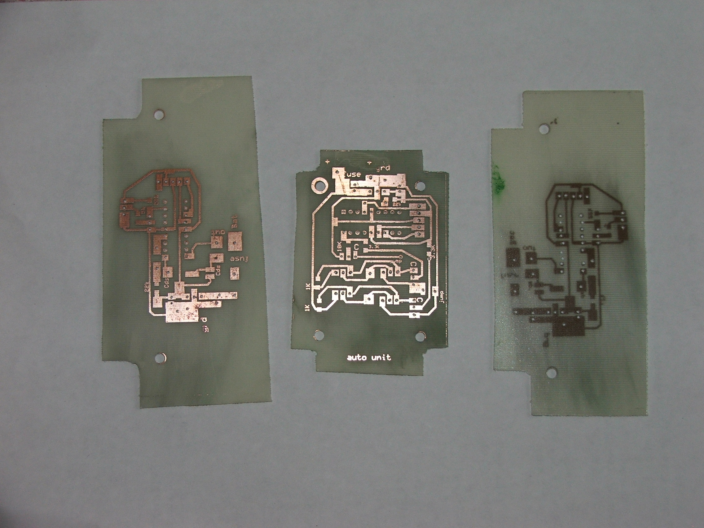

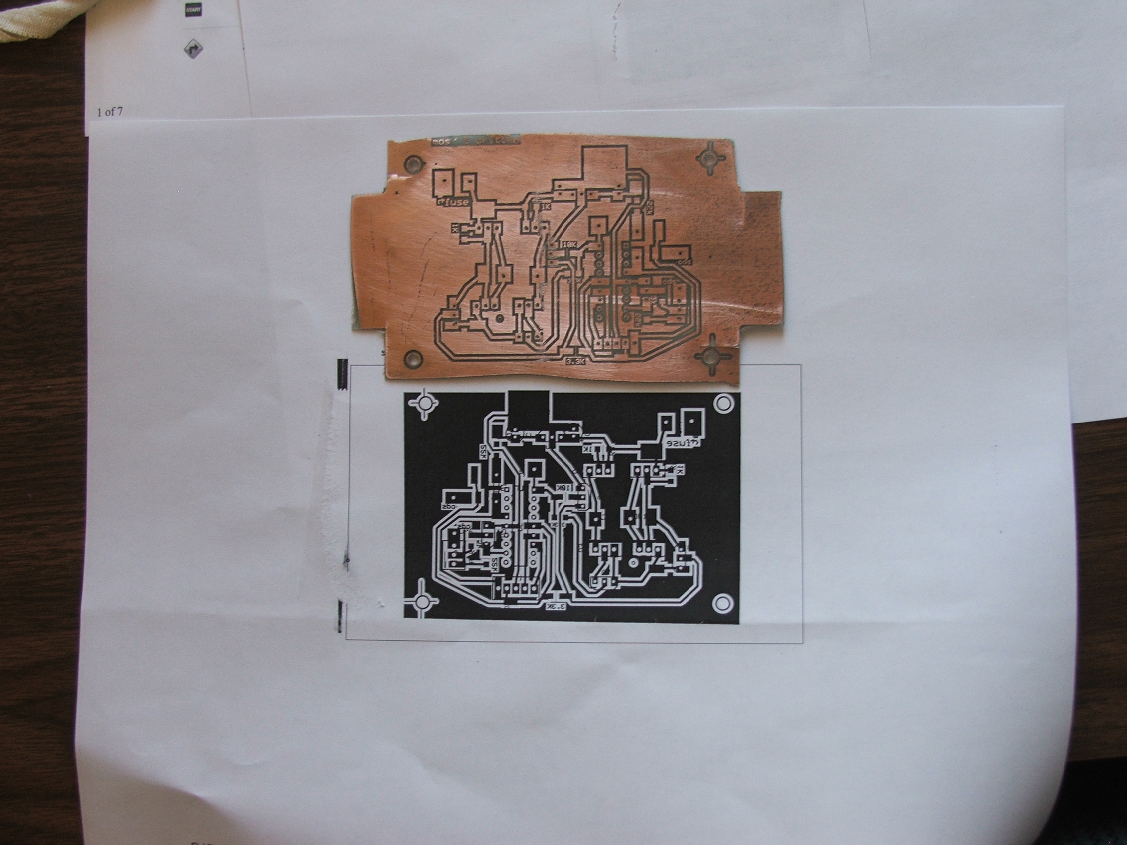

IF you etch then drill you end up with a crater that helps align the bit. It really is very easy. I use the thin pcb from pulsar which are somewhat transparent after etching. Very easy drilling (you can get FREE board material from PULSAR as well) with any order unless you want to just pay for shipping.
I have been able to drill out boards with 40+ holes in under 20 minutes. I have a very bright light shinning on the board as well.
attached are some pics
