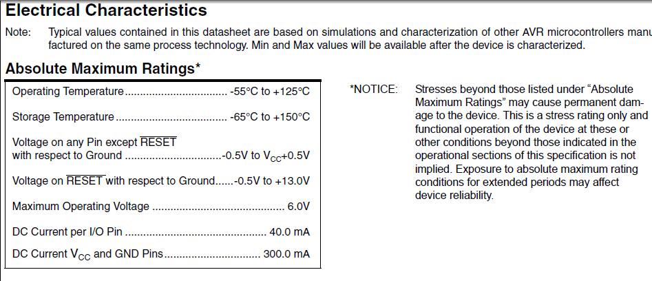

i made a 7segment clock using atmega8. I connected the 7segment pins with 500Ω resistor to uC , i did not use any transistor. My 7Segment each leds are rated 2V 20mA. the display is bright enough and i like it. Will this arrangement kill my uC because i am consuming quite a good amount of Amp. I was not able to find how much mA atmega8 can handle as output.

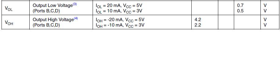

from page 243 of the data sheet for the ATMEGA8, electrical specifications:
5v voh - 2v vled = 3v (worst case, since voh would be 4.2V @ 20mA, higher for a lower mA)... 3v/500ohm = 6mA per LED. assuming four 7 segment LEDs, 28 x 6mA = 168mA total. Well within the 300mA limit.

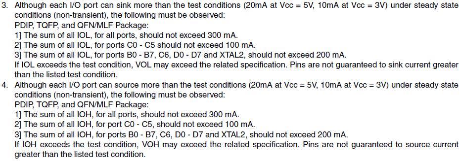

again, from the data sheet... read the notice to the right...
it may do nothing, one day it may quit working, any or all of it...
The whole chip will run hot if you get close to 300mA. If it is in open air or has a little heatsink it would be reliable, but with no heatsink and in a hot enclosure it could eventually kill the chip (enclosure can be hot especially if they have a mains transformer and voltage regulator inside).

You never want to run parts at, or even near, their maximum operating points.
The reason that 5 volts is used even though parts can tolerate 6 volts, is so tolerance of voltage accuracy, and transient voltage spikes, don't kill the parts.
Exactly like Chris said, you NEVER want to exceed ABSOLUTE MAX Ratings, so don't operate near them...

if you're already multiplexing, you can drive them a lot harder... try 220 ohm resistors (5-2/220 = 13.6mA; 13.6 mA x 7 = 95mA. This is good for port C. As long as you are driving from port B or D, you can go down to 150 ohm resistors to drive the spec'd 20mA (7 x 20mA = 140mA). The absolute max is 40, so you're good to go from there.

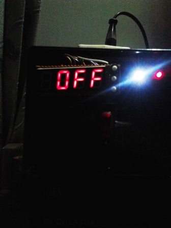

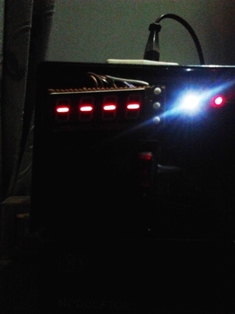

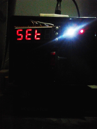

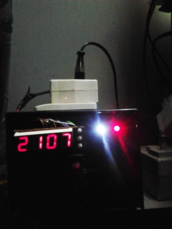

some pics of my clock come timer. I am using 520Ω to drive the 7segmen because thats all i had in hand. In my next edition i will decrease the Ω.
My timer/clock has 3 button just next to the 7segment, one button to choose set clock or set on or set off you can see a horizontal line in top,middle and bottom as per selection. 2nd button for hour++ and 3rd button for min++. no - :eek: it goes to max then to zero. The 2nd and 3rd button has another function, in normal running mode 2nd button shows on time and 3d button shows off time when pressed. Red light is power on, white light is relay on.
