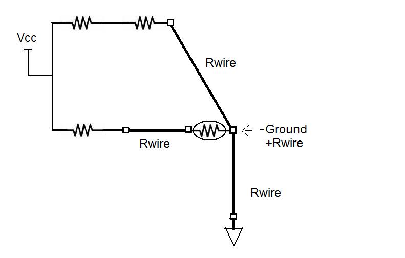

Thanks a lot for the detailed explanation. I have read it all but feel a little confused over something you mentioned under the EDIT.
1. How will there be a voltage drop across ground?

One thing I wish to mention is that the lengths of the RTD will not be known to the circuit and to me also as a designer. (they vary with site and installation)
So, what value pot (10e + 100e as of now) would be sufficient to compensate for the actual wire resistances?
If I connect the third RTD wire directly to AMP, as shown in the schematic you posted, will it's length (and so the resistance) will ever matter in the measurement?
I took the 3rd wire grounding approach just to compensate for the Unknown lengths that RTD wires may have in the field/on application site.

"How will there be a voltage drop across ground?"...SEE ATTACHMENT
The resistance of the 3rd wire is the same as the resistance of the other leads. I am correct in that you are connecting this wire to ground? I am assuming not earth ground though, because you are using a SMPS correct? SMPS is a floating voltage source, the output is isolated, so Earth ground will not be proper. Your ground lead would need to be routed with the other rtd wires back to the circuit board to common on the power supply. The length of that wire would be Rwire and thus your bridge would be Rwire above ground. No big deal but not ideal.

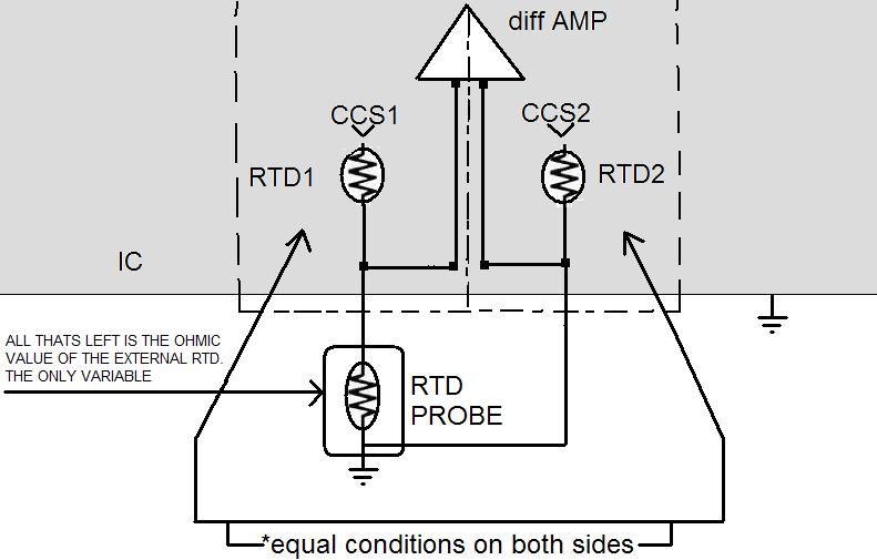

I uploaded a drawing to explain the common-mode rejection operation of the IC circuit in your PDF. You can see how there are two reference RTDs built into the chip, with 2 constant current sources for both branches of the circuit. It is very similar in a way to a bridge circuit, except that in a bridge the balance is achieved by the bridge itself. The CC circuit doesn't care or rely on balance, but does succeed in eliminating the influence of all resistances except the variable of interest i.e. the RTD probe itself. You might call a common mode rejection design an "ALL THINGS BEING EQUAL" circuit. The internal RTDs are simply references that help stabilize the two branches of the circuit, negating temperature influences on the integrated circuit that might occur, if I understand it correctly anyway.
I hope this helps you understand the difference between a bridge design and the constant current design concept.

I don't know any better way of explaining this. If you use the 3-wire design that I suggest is best, the 3rd lead will not be a current carrying lead. It will only be a voltage sensing lead. The high input impedance of your amplifier will prevent significant current flow. In this way it will be like the input of an FET device in a digital circuit, not loading the gate in any way. You do know how FETs are voltage controlled devices? The same principle applies. I should think your differential amplifier should be a CMOS device ideally, and judging by the input impedance you described it likely is. I haven't looked up any datasheets here BTW.
There will be little to no current flowing between the sense voltage at the RTD and the corresponding amplifier input, so resistance will be a non issue. Please tell me if you understand this? If you do not, consider that when designing an FET transistor gate input, a designer is free to choose among pull up or pull down resistor values with a lot of liberty. The proper switching of the FET device will occur whether the impedance is 100k or 10meg, the only variability becomes the speed at which it switches. Here, the only variability that input impedance has on your amplifier is its responsiveness, the speed at which it responds to changes in the RTD. Whether your lead impedance is 1 ohm or 10 ohms, there will be for practical purposes NO noticeable difference in response time. The value is too low to be of any consequence.

Well, that would be an external resistor added in series with the constant current excitation of this particular module. Probably for current limiting, setting a maximum current, perhaps in case of a short. It would also probably be there to mitigate the heat effects of circuit current. RTDs self heat to a certain degree if too much current is used to excite them. Remember, they are only 100 ohm devices and if the voltage applied becomes too great the current might become excessive causing self heating or even damage to the circuit. Be aware that each integrated circuit you look at will have its own peculiarities of design. Also, this again is a constant current circuit so design considerations will be different from your bridge circuit.
