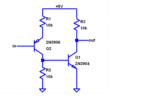

I have this weird output. When the signal is true, the voltage is 5.0V, but when it is false, the voltage is 3.3V. I need to convert this to a ttl logic level, so that it remains 5.0V when it's true, but it changes the 3.3V to 0V when it is false. Does anyone know if there is a component that does this? I really need suggestions.

Below is a 2-transistor solution which is noninverting. Sebi's circuit will invert. John's circuit is an emitter follower, and the output will swing from 4v to 5v as the input swings from 3.3v to 5v. A comparator such as LM311 or LM393 will work.

Sebi, the input swings from 3.3V to 5V, so the threshold should be 4.15V.
See below.
