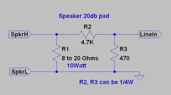

I have a audio signal from an amplifier, that is meant to drive a power speaker. I now what to use this signal into a sound card.
Is there a simple solution?

Elaborating a bit. I would use three resistors: one to act as dummy load for the amplifier, and then two to make the attenuator:
Word of caution. If the speaker is driven from a bridged amplifier, you cannot hook SpkrL to the grounded input to the sound card. Unfortunately, computer sound card line and mic inputs use the computer case as a common ground, which is connected to earth ground via the power line. I have had to use a transformer to provide isolation to solve this problem.

You're making life far more complicated for yourself :D
You don't need a dummy load, UNLESS it's a valve amp - and even then it's going to be very expensive and will make a good toaster as well (for any decent size amp).
A bridged amp is no problem, you simply take the out put from one of the speaker connections, and the other from chassis.
Thanks Nigel,
Two 1/4 watt resisters should do the trick like this?
(Audio+) ----- (10k Resistor) --X-- (1k Resistor) ----- (Audio-) X
I would then tap a points X to my sound card?

...A bridged amp is no problem, you simply take the out put from one of the speaker connections, and the other from chassis.
Except for the fact that the output of a bridged amp is biased at about 6Vdc (Half the supply voltage). You might need a DC-Blocking capacitor.
Also, I have tried running solid-state amps unloaded (or loaded only by ~5k) and the audio output was not well behaved. It had a lot of overshoot/ringing on it...
It would be a reasonable idea, but by no means essential, as the input you're feeding will (or SHOULD!) have such a blocking capacitor for that very reason.
You need to use better amps :D

Sorry for the slow reply - but yes.
The right hand X is ground, and should connect to both computer and amp, the middle X is the audio feed to the sound card.

You could if you were picky use a matching transformer, car radio dealers usually have them, its just a pair of transformers to drop the voltage in a little tube with speaker wires one end and phono sockets the other, this sorts out the dc issue (built in caps), reduces noise (attenuates it) and isolates the 2 devices to avoid any earth loops.
