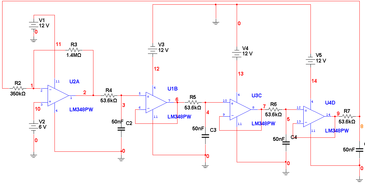

Ok.. I am currently working on a project in which i want to convert a DC signal to AC signal. after much review i decided to go with a bubba oscillator to just obtain a 60 hz signal. my problem is how do i go about using the 12V Dc that i have to obtain that 60hz signal. any helop would be greatly appreciated.
thank you brown out for that reply, but I dont think the problem is the connecting the supply. I recently successfully connected my circuit but then after i did so and i ran a trial simulation in Multisim i began oscillating after a few seconds and began amplifying the circuit but never stopped. it appears i might have a problem with my feedback loop and help would be greatly appreciated. also any help in deriving the specific 60 hz frequency given your choice of resistor and capacitor using the information below would be greatly appreciated.

hey guys i am sorry i didnt put more information. i do appreciate you guys responding to my post as your hell is greatly needed and appreciated. anyways i added the multisim file so you guys can let me know where i might be going wrong with this design.

Sorry again guys, it seems i am having more problems providing sufficient information than solving my oscillating problem. anyways i attached both the png file and a pdf file. so i hope this is much better.

Try 1.5M for R3. Are you telling us that this doesn't work in simulation? Of have you built this?
well it is my intention to build it. but it does not work when i ran a simulation on it . i also tried the 1.5M for R3 and that too does not give any result.

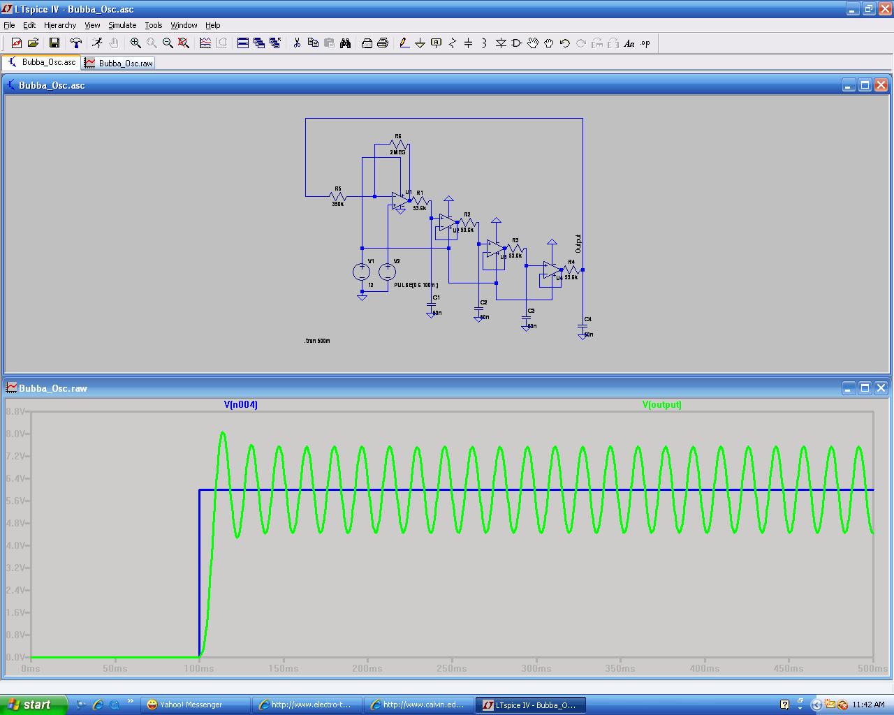

I got it to simulate correctly in LTSpice. I had to do 3 things to make it work:
1) Correct your VCC connection error in the far-left Amplifier
2) Change your R3 to 2 MEG ohms for sufficient gain
3) Make the 6V a rising edge. Because simulators assume all initial conditions are steady, you need some kind on stimulation to get oscillations started. In a real circuit, these conditions usually exist.
hey brownout, thanks for in information you provided, again i appreciate it very much. i corrected the VCC connection problem as well as changed the value of R3. my only concern is the 6V being a rising input. are you telling me i have to make it a square wave input or someting of that sort. and can you elaborate on your explanation a little bit more cause i did not really understand .sorry for the trouble if any.
The 6V does not need to be a sqaure wave. You can see in the waveform I posted that it is just a rising edge at 100ms (blue trace) and that it remains a constant 6V after that. All oscillators need something to get them started. In real circuits, that can be a switch on transient, or just random noise. Usually, something is there for starting. I've seen other oscillators that include a starting circuit, but these are rare. If you build this circuit, it will probably start correctly. But in simulations, you might need some kind of transient to make it start. Until now, I haven't simulated an oscillator, so I had to learn that too.
