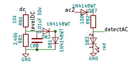

Microchip say 10k max at the voltage of interest.
The impedance at the ADC input is about 10k. (100k||9.31k)+1k Thats 100k parallel with 9k then add 1K. MicroChip is not talking about the resistance to the voltage source but the impedance. (from the ADC's point of view it looks like a 10k to 8.3 volts)
Inside the ADC there are input protection diodes. (to ground and to supply) There diodes can only take a small amount of current.
The diode on the outside limits the voltage to -0.7V. The internal diode limits the voltage to -0.3V. That puts 0.4 volts across the 1k resistor or 400uA.
The same story on the supply side.

The impedance seen by the ADC pin equivalent of paralleling the two resistors used in the divider.
It's under 10K.

Put a ohm meter from ADC input to ground and you will measure near 10k. This is the impedance as seen by the ADC.
1537042485212-png.114553
Ok I see where you're going with this but the 100k is key here not impedance to ground. As Pommie described the PIC ADC uses sample and hold so the 100k isn't going to cut it.
The source impedance as seen by the ADC is the Theavenin equivalent, in other words, the parallel of 100k and 9.31k = 8.51k.

You're not measuring the line voltage but the voltage after the divider, so 10k impedance.

OK so the ADC sees 10k to ground, but the 100k is still restricting the current too much. This is the part I don't understand.
The 100k has 100 volts across it while the 10k has 10 volts across it. (assuming a simple divider and using rough numbers. (same current) So 100k and 100V pushes into the ADC in the same way that 10k and 10V does. (that is a strange way to look at it and certainly not how I teach electronics)
A different way to look at it: If we put a 0.1uf capacitor on the output of the divider, it will roll off the high frequencies. The frequency response will be (cap & 10k) not (cap & 100k). If you have SPICE you can test that.
A different way to look at it-2. Voltage divider; now take the bottom resistor down to 0 ohms. (what is the impedance of the output?) (hint the 100k has no effect at all in this case)

Several posts ago I told you it is the Theavenin equivalent. Google it.
I still don't get it. The 100k is restricting the current into the ADC. By too much. What am I missing?
What you're missing is exactly what schmitt trigger said: basic circuit theory. Specifically, the fact that from the ADC's point of view, the 100K and the 10K are in parallel and that it is the resulting parallel impedance-- and NOT just the 100K resistance-- that will determine the ADC sampling time needed as well as any static errors due to the I*R drops due to the ADC's input leakage current.
Stop distracting and confusing yourself with informal, intuitive stuff like "the 100k is restricting the current into the ADC" and stick rigorously to circuit theory. Intuition can be useful, but ONLY when grounded in a solid understanding of circuit principles.
