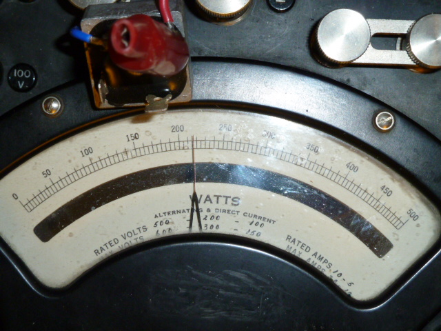

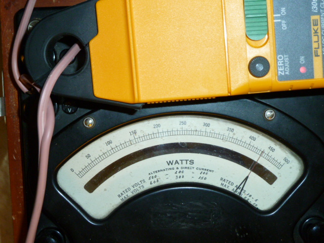

I was told in high school that using a diode in series with a soldering iron would reduce the power to 1/4. I have not been able to find any proof of this theory. Have I been living a lie all these years?
You've been living a lie.
Here is experimental evidence; whether you consider it proof is up to you.
I used a Weston wattmeter to measure the power consumed by an electric toaster. The toaster is essentially just a nichrome wire connected to a line cord.
The first image shows the wattmeter scale with the toaster connected and no diode in series. The reading must be multiplied by 2 because there are 2 current ranges on this wattmeter--5 amps and 10 amps. I was using the 10 amp range. You can see that the reading is 437 which multiplied by 2 is 874 watts. You can also see below the scale that the wattmeter can read both AC and DC. You can also see the Fluke clamp-on ammeter in the image.
The second image shows the reading with a diode in series. I used one diode of a bridge which can be seen in the image. The reading is 216 which when multiplied by 2 is 432 watts. Notice that this is a little less then 1/2 the value with no diode. The diode drop reduces the power a little.
Hair dryers use this diode-in-series technique to reduce the blow dry power when you select a power level less than full power. The dryer is drawing several amps of DC current from the outlet when on medium power. This current is not enough to hurt the pole pig; it's just not enough to push the core into saturation very far.

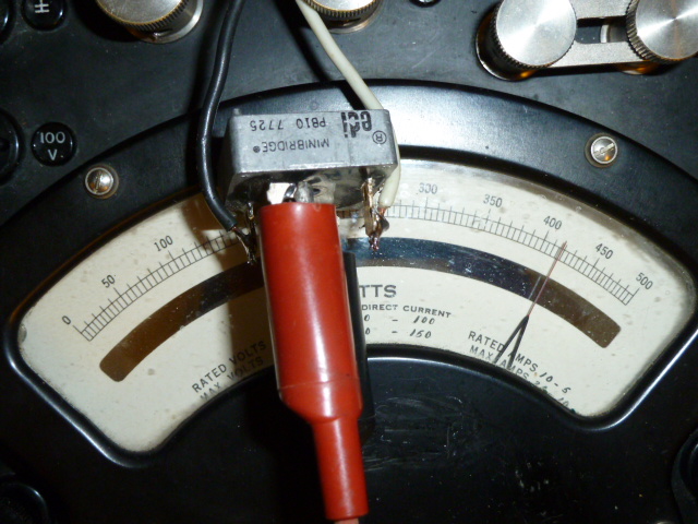

Hay thanks for taking the time to do that experiment and for destroying my high school 1/4 watt theory.
While you have the stuff out, Would you mind trying it again with full wave rectification and see what you read?

Thanks for taking the time. Truly a classic watt meter. Back in the day I loved those units. Weston made some really great meters like the one shown. Unfortunately I saw many go to a dumpster before I could dumpster dive and rescue them. Thanks again for taking the time and the images. I was going to do it this weekend, now I can do real important stuff like getting the beer cleaned out in my fridge. :)
Andy
OK. Don't read too much into this value. The first images were taken close together in time; this one was taken about 3 hours later. The line voltage may have changed (probably decreased) because it's later in the afternoon. This is the same toaster load with a full wave rectified grid voltage applied.
