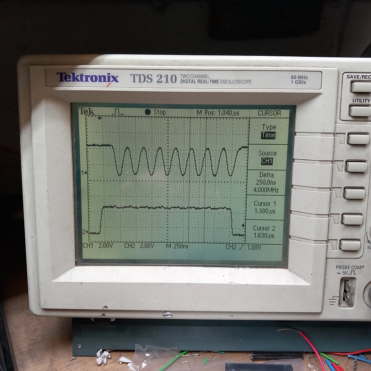

If you are referring to the SPI bus it does not need pull-up resistors, and the only pull-up resistor I use is the MCLR pin bias resistor. If you don't use MCLR it is disabled in bit configuration. I was looking for a Pic18F46K20 at home but I don't have one to test.
Hi D,
The Pickit3 uses the MCLR pin, then it is pulled up by the resistor.
If I have spare 18F46K20 I can post one to you if you PM me your address.
C.

Hi I,
I think this is the program that was on the 18F46K20 PIC, which showed changing colours and TEXT on the screen.
C

Do you have another board you can test? Leave off the pic18f4431 and watch the SCL.. at the moment I do not get proper switching ... Here is the clock at 4Mhz
Look at the data signal (bottom) rise and fall more than half the clock.. This is either the chip itself or stray capacitance... Now both these signals are on the same port.. I also see the peak to peak IS 3,3v so we are getting neg to pos... I wonder if there is a slew issue here.. let me divulge the datasheet see it there is a setting.. I do not use the 3v3 devices..
Turned off the slew control.. The data was far better but no affect on the clock...
Reading more... see you later

Yeah! but slow.. If I jack it any higher than 4Mhz the signal slowly disappears..
@4Mhz you can see we'll get something..
On Monday I will take a scope reading of my pic18f46k22 scl and data you can decide..

My ILI is running at 8Mhz just fine.. Now I know the SLRCON set to 0 helps I'll give that a go..
Also!! There is an SPI setting (SMP) to drag the data read to better the read performance... I'm giving that a go.
We'll see As for those settings... I know full well abut the SPI MODES CKE and CKP set the mode.
