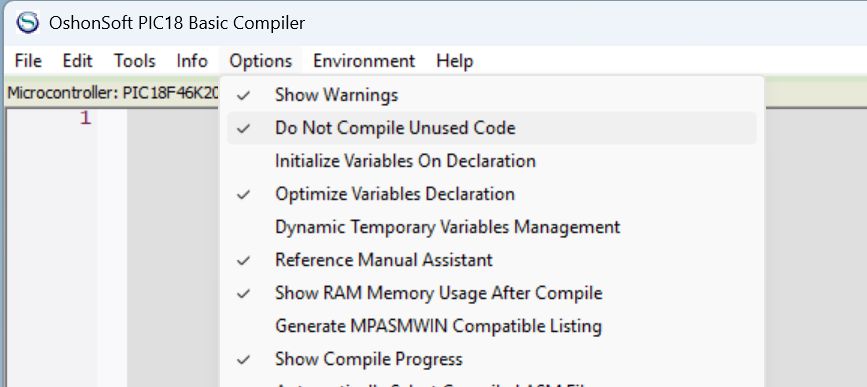

I understand that the serial port is configured with the standard pins C6 and C7.
The next step is to have the same configuration in the IDE:
Options:
The "Initialize Variables Declaration" option has to be disabled.
In Options again:
Open "Advanced Compiler Options" and select as follows:

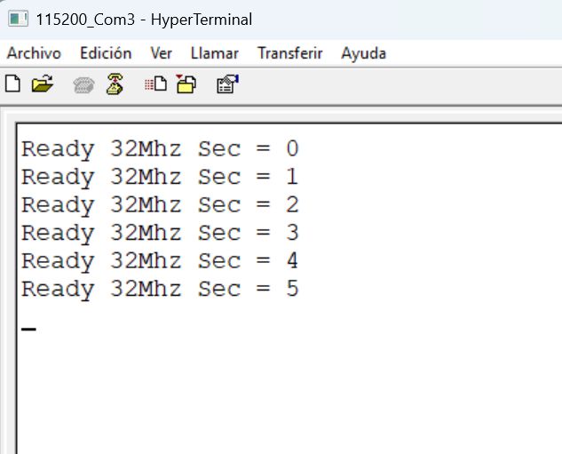

Once you know that the configuration is the same, test that everything works, load the .hex file and having the card connected to the computer to the serial port and to a serial console configured to 115200 Bauds, test that it works, this is what the serial terminal should show:
If everything goes well we continue.

Now we are interested in knowing that the clock frequency is what we want.

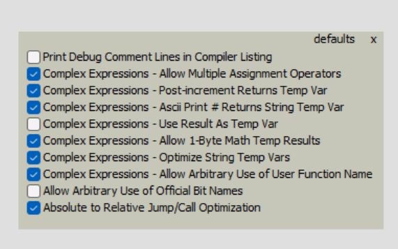

It’s not that this configuration is magical or that applying it will automatically make all your previous codes work. That’s not going to happen. However, this is the configuration I use to avoid slight discrepancies between your code and mine.
For example: If I write the following in my code:
Dim x as Byte
Dim y as Byte
x = 1;
y = 2;
x = y = 3;
With the configuration I propose:
  • x = 3 and y = 3.
Without this configuration, multi-assignment cannot be guaranteed to work correctly. Additionally, there are other minor details, such as the automatic initialization of variables in functions. Personally, I do not use automatic variable initialization.
When working as a team to solve problems, it’s best to use the same configurations. Once the problem has been resolved or the environments have been synchronized, everyone can use their preferred configuration.
