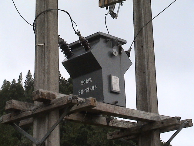

Pole transformers
Here is one photo from a TX out in the whops.
This one is in a remote area of the Coromandel peninsula, North Island, New Zealand.
Supplying power to a radio transmitter.
50 kVA 11000 Volts S.W.E.R. system.
single wire eath return.
When i take the pics from the pole mounted city TX's i probably open up a new thread so all TX related pics can stay together.

That one on the photo is only a small TX. ( 50 kVA )
It weighs around 400 KG's
Because of the SWER wiring arrangement these are usually mounted on a 2 pole structure.
Similar TX's of the same size or bigger are often mounted on only one pole.
Photo's will be posted.
Regards
Raymond

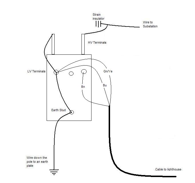

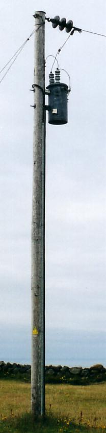

OK does that mean that there is one overhead wire with 11kv and its return is via "earth" ?? Like the picture below.
I have also attached this pic elsewhere on this board some time ago.
Anyway, I was back in Iceland a couple of weeks ago and had a chance to look at the transformer again.
It is rated 11kv to 230/460volts (cant remember KVA). It is powering a lighthouse on the south coast if Iceland near Vik.
When I examined how it was wired, I was mortified. See the sketch.
Any comments Rodalco? You seem to be well experienced in "big power"!

That is the correct way of connecting a s.w.e.r. system.
There is usually a huge earthbank in the ground to ensure a good earth continuity.
In remote and windy areas it is cheap to run long cables in swer with only one insulator and one wire to deal with. ( no more lineclash problems )
The supply feed in, usually comes via an isolating transformer 11kV 2 phase / 11 kV swer, otherwise the substation feeder or sectionaliser will trip out on eath fault.
The 230 / 460 Volts output is available from the 4 LV terminals.
The phasing is 180° apart.
Connect secondaries in parallel, link X1,X3 and X2,X4 gives 230 V at double the current.
For 460 V link X2 and X3 and earth these, take off from X1 and X4 at 460 volts, to keep line to earth voltages below 250 Volts.
The photo in my post is a 2 phase to 1 phase isolating TX.
I add some more pics in the next couple of days.
