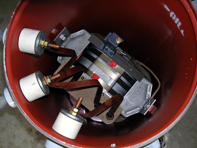

I'm more interested in seeing what's inside those metal cans.
Does anyone have any pictures of transformers dissected?
i saw one on the net somewhere, i'll try to find it.
i saw another one somewhere, but i can't seem to find it. anyway here is one pic. pdt3.jpg
Pretty much the same thing you'll find in any transformer, wire and insulation, just more, and bigger.
Why do you suppose they use flat copper strap in there? Low impedance or just easier to bolt to the lug?
i think it's because you can bolt it easy, you can't bolt round wire easily. you can't use solder due to the temperatures, so they bolt it. that's what i think anyway.
I've peeked into the recitfiers (1-20kw) we have at work (some junk) and they're all wound that way. I'm asuming it's just about everything, including increased capacitance I mean it's the same way a rolled capacitor is constructed. If you notice it's not just the ends that are ribbon, the transformer windings themselves are ribbon.
Flat conductors waste less space on the bobbin, and maintain flexibility even when the cross section is large (they just get wider). You can wind bare copper and insulate with a membrane (paper?) And if you choose your thickness carefully, you can eliminate skin effect. Try to bend an insulated large diameter wire, in a tight radius, and the insulation just cracks.
You'll see flat conductors in the high current windings of switching power supplies.
I've also seen many thinner copper enameled strands paralleled to form a ribbon, I imagine that this eliminates the skin effect even more.
