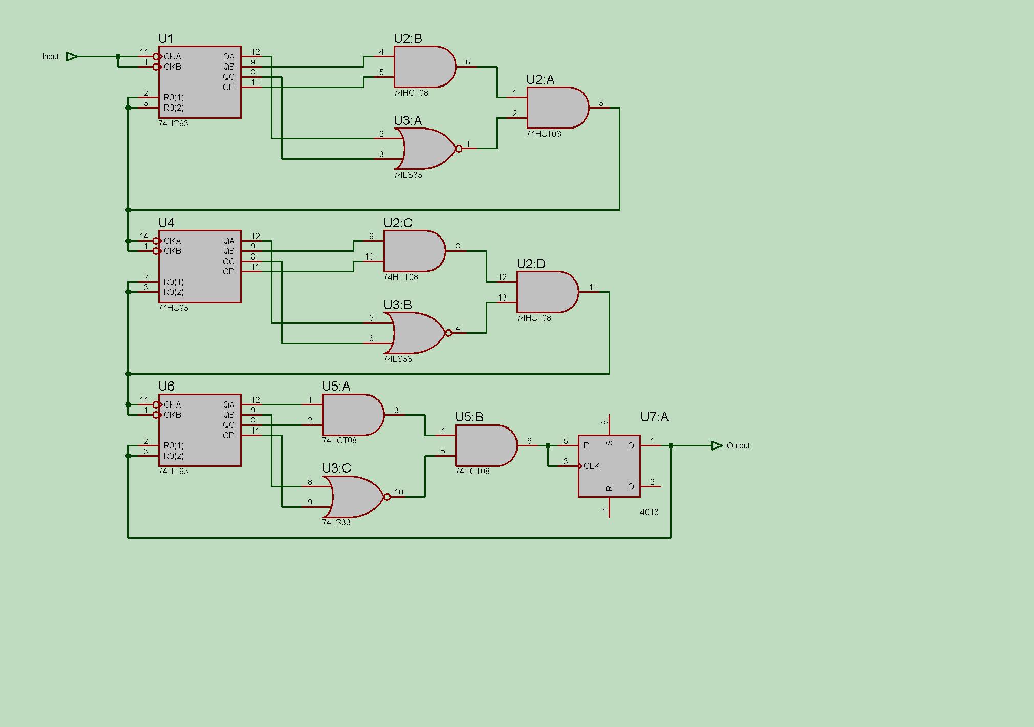

Circuit: Now with crunchy pieces of MSI and discrete logic.
U1 and U4's supporting logic act to reset them and increment the next significant counter. U6 acts as a Divide-by-5, and it's supporting logic drives a D-type flip-flop that acts as a Divide-by-2. Someone with experience tell me if that would work ;-)

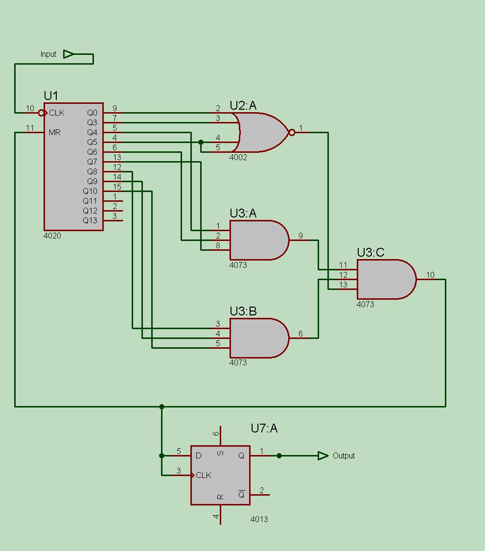

Okay, I'm stupid, I way over-complicated things. Here's a new schematic with a Divide-by-500 glued together, and a Divide-by-2 to latch it. Nevermind the part numbers obviously, you'd have to use matching TTL or CMOS parts to equal out the logic levels.

The 74HC93/4020's in your present circuit are asynchronous counters, you could have problems with gate glitches.
A: I'm not building anything, just trying to show the OP what logic you'd need.B: What do you think of the revised one with a single counter and only 4000-series logic?
Hi AG,
Sorry AG, its a case of my typing finger being quicker than my eye...:o
I think the 4020 ripple counter glitches will cause misoperation of the 4013 F/F.
You may have to add some simple R/C filters on the outputs of the 4020.
