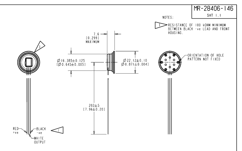

Here is a pic from the datasheet of the DigiKey mic with wires. It has 3 pins :eek:
A microphone has a very low output level. A microphone preamp increases its output level to make it more sensitive. We do not know if the input of the DVR is for a microphone level or for a preamp's output level.
The detailed datasheet from Knowles of the MR-28406-146 mic shows that it has an awful +8dB to +20dB peak in its output at 5kHz. It is usually powered from only 1.3V but it is functional up to 20V. It's circuit has a 10k resistor added from its output to its black ground wire. Its black wire should connect to the shield of its connecting cable.
What specs would you suggest I look for so I can go ahead and get a few ordered? I will plan on soldering the mic to a board along with anything else that is needed to get the audio I need. This is all going inside a weather proof enclosure. When I finally get all of this stuff configured properly, I can then think about getting a PCB designed and manufactured.
The Knowles mic you selected from Digikey is designed with "bellows" on it to be used under water. That is probably causing the awful peak in its frequency response. An ordinary omni-directional electret mic (most have only 2 wires, signal and ground) is sealed and rain drops make noises but do not enter it. The case and wires might get corroded of it is exposed to weather.
