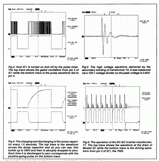

PLEASE TAKE NOTE OF WHAT WE ARE SAYING Don't in anyway put any amperage thru the wire. That schematic I put up before works off 12 volts DC not AC and only draws 190mamps from the supply. It puts out 3.6 Kilovolts but no amps. I've got bore goats and where I have the electric fence they wont go near it after touching it.

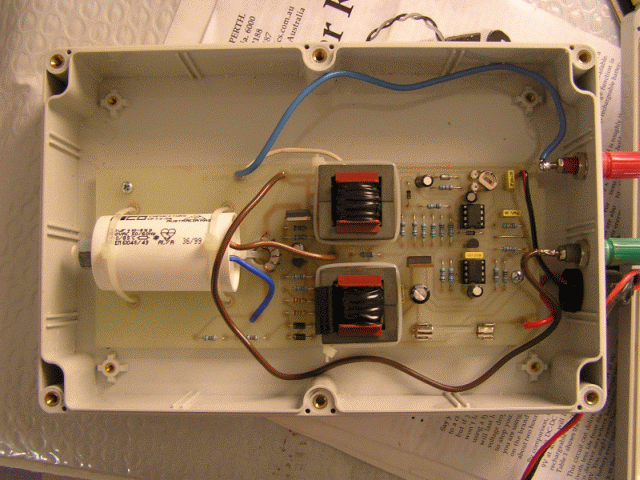

Ok mate here's a photo( taken wiff my nu digi camera :D ) of the fence controller I made as you can see it uses a dump capacitor to deliver the charge. This circuit is designed to send out a pulse every second. Now I bought this project as a kit from Dick Smiths here in Oz about 2 years ago, as it's a discontinued kit I don't think you can get it anymore but I can photocopy the entire instructions which has a circuit board layout along with full construction details. If you want me too I'll do it but it will cost a bit to source all the parts.
Cheers Bryan :D

Ok here's the details from an osciliscope showing the various waveforms and tesla it does only draw 190 milliamp off 12 volts as it only driving basic circuitry the punch is in the second stage as this will show below

Here's a photo( taken wiff my nu digi camera :D ) of the fence controller I made
Thanks Bryan! Man, that capacitor looks even smaller than the standard one that I use to drive my littly power supplies! Certainly nothing prohibitively expensive here. I think I shall build one, although I don't like the 1s thing. I realize the importance of a duty cycle that lets people escape, but that's too long... I will adjust slightly.
BTW in your schematic, what is T1 and the other one sharing the same symbol? That one with 2x turns on the secondary? Sure hate to see you have to diagram one with not such a pretty ratio.
But anyway, you never did (I don't think?) say if, and how much, more current it consumes when someone's being nuked. I guess that's for obvious reasons... lack of a subject to get executed! No matter, I suppose, I can calculate from the schematic you were nice enough to provide! Thanks again for that one; got it saved.

Eh Tesla,
That deailed data came straight out the construction details. Later tonight if I have time I'll scan the construction details, zip them up and post them here for you and anybody else that wants them. This project was designed by one of the guru's from siliconchip back in 2000 I think (can't find the mag) but you might get lucky looking on www.siliconchip.com.au
