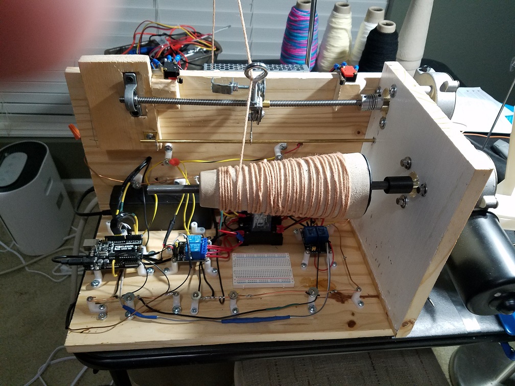

for all you yarn handlers out there, here is a picture of my yarn winder that shows the mechanical layout pretty well. The long horizontal metal item in the back is a jack screw with follower. The follower has a yarn guide on it to move the yarn back and forth across the moving yarn spool.

Can I ask how you keep tension in the yarn?

I went cheap. Two rubber bands and two pieces of wooden dowel. One piece held to the other with the rubber bands that set the tension. The dowels are held in a lab stand. I adjust the tension by how tight the rubber bands are wound. Cheap and effective. I am using one sixth hp motors, geared down to 100 rpm. I think they wold pull walls down if I let them so I can wind as tight as I want.
