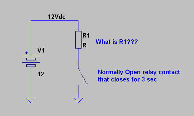

I am still confused by the term "-12V pulse output".
Do you mean that you need an output that normally sits at +12V (actually more like 14.4V if the car is running) that you have to pull to ground for 3 seconds? Is that what you want to use a relay contact for? How much current would the relay be sinking? In other words, what is connected between +12V and the relay?

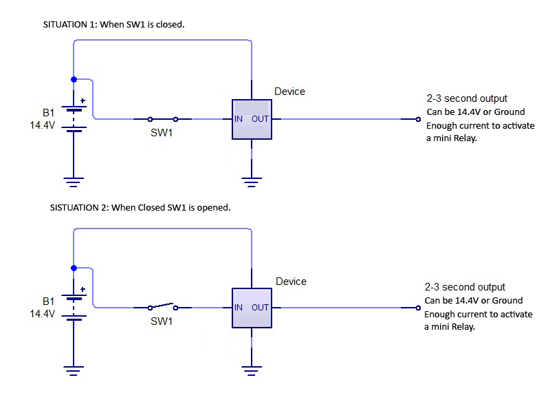

Is this what you mean:
This pulse outputs will be used to activate/deactivate the turne signal lights that o this car is controled completly by canbus type comunication and can not be hardwired.

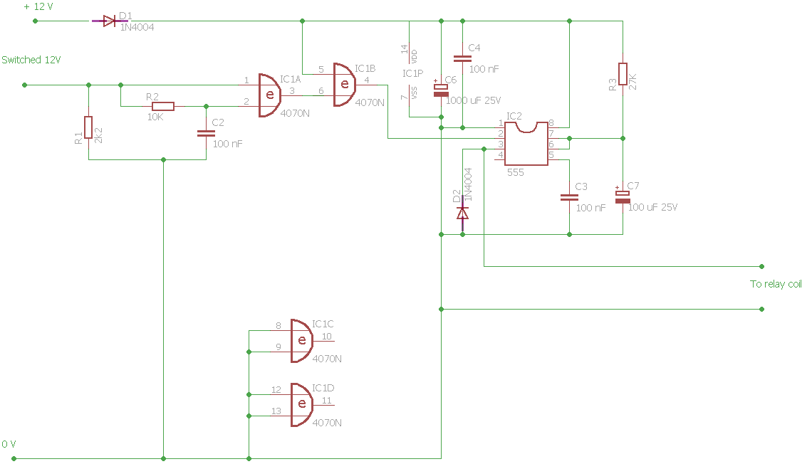

I would suggest using an exclusive or gate. One input connected directly to the switch output and the other input via a resistor (Say 10K) and a capacitor (Say 100 nF) between that input and ground. The output will pulse high for the short time that the inputs are different. The output of this could then trigger a NE555 timer to produce the 2 to 4 second delay. It MIGHT even work without the 555 just by having a longer time constant for the capacitor/resistor delay network on the input of the exclusive or gate. As you would probably use a cmos gate you would need a transistor on the output to provide enough current to drive a relay.

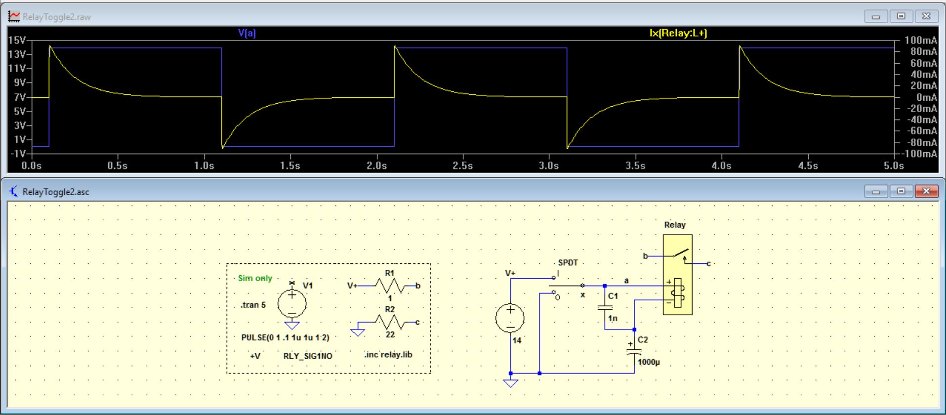

Ok. I don't see why you need a 2-3S 'on' time for the relay. Surely the CANBUS will respond in a fraction of a second? If so, a non-polarised relay could be be very simply double-pulsed using a SPDT switch and a fat capacitor, like this :-
C2 is the fat cap. C1 is for voltage spike suppression.

Can You make a diagrama for that. Thanks in advance.
This circuit should do what you want. I had forgotten that thew 555 requires a negative trigger pulse so I have used one of the XOR gates in the package as an inverter. ( You could use an 4077 instead of a 4070 and you would nit need to invert it's output.)
The large decoupling capacitor (C6 1000 uF ) are to try to make it less likely to be triggered by noise on the 12 volt supply.

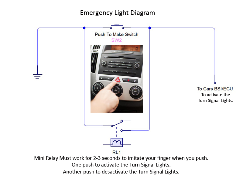

I hope this diagram will leave it more clearly on how the emergency light button Works:
arm755:
This clears it up...
However, I would like you to make a couple of measurements with a DVM.
1. Set the DVM to DC Volts mode to read ~15V. Put the red probe on the "BSI/ECU" signal. Put the black probe on car's ground (chassis ok). Measure the open-circuit voltage and tell us...
2. Set the DVM to DC mA mode, start on the 1A scale. Put the red probe on the "BSI/ECU" signal. Put the black probe on car's ground (chassis ok). Measure the current. You may have to make the meter more sensitive. Do not be surprised if you turn on the flashers while making this test. Tell us the current reading with probes connected.

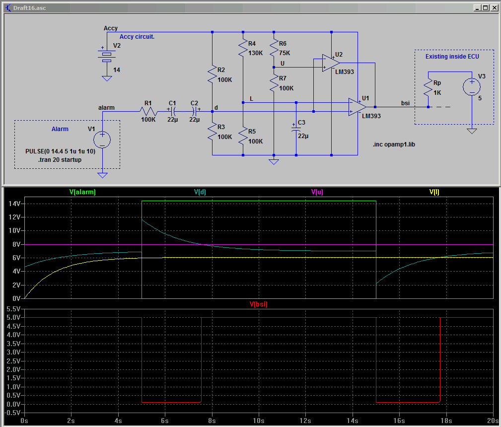

Pending the outcome of the measurements I asked you to make in post #17, here is circuit that probably does what you asked for. Without having your current measurement, the one caveat is can the LM393 sink enough current to pull V(bsi) low? If after you make your measurement the answer is no, then there is a simple mod that will boost the current sinking ability of the circuit.
I am using a window comparitor circuit to drive the bsi output pin. The alarm signal is differentiated, and the two comparitors detect if either the alarm signal just turned on, or just turned off.
There is a start-up inhibit part to this circuit, to prevent a spurious output during application of power.
The two LM393 comparitors are available as in a 8pin dip package. The Accy line is just a fused version of the car's power. The dashed box on the right is my guess of what is inside the ECU. You will confirm my assumption if you make the measurements I asked for.
One push to the button to activate the turn signal lights, second push to the button to desactivate the turn signal light.
:banghead: That isn't what you asked for originally. The original post wanted switch closure and switch opening each to generate a pulse. Our efforts so far have been aimed at that original requirement.

This would be not necessary since I will use the same 2 original cables the hazard light push switch uses, and make the micro relay do the job of the push switch. Simple.
The grounded cable on the diagram is the original cable that I measured and actually is grounded.
The other original cable as You can see on the diagram goes to the BSI.
The current use must be small since both 2 original cables are thin cables.
