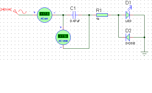

i need an LED to display wether the mains power (230V) is on or off. whats the best way to do this without a transformer? can it be connected to a rectifier directly to the mains (obviously with a resistor in series)
A neon lamp would be much more appropriate that an LED if you want to run it directly from the mains.
It can be done with a capacitor, resistor and diode, but it is bulky. The capacitor is chosen to drop most of the voltage due to the capacitive reactance. Make sure that the capacitor (rated for AC purposes) can sustain the required ripple current and have a high enough voltage spec.
As from the attached picture the current through the LED will be pulsating DC

...and if you do use caspacitor to knock down voltage, please do yourself
a big favour and put a resistor IN PARALLEL with C1 capacitor
(something like 100k 1W for example).
circuit as shown above would work but when you unplug it,
there is nothing to drain down the capacitor charge. (are you ready
for some nasty zapps?) also i would not use only half period.
small bridge rectifiers are dirt cheap and small (or just put 4 diodes).
if you want low power device, consider using small transformer from
wallwart. they are not any bigger than high voltage capacitor,
you get isolation and lowest power consumption...

What you guys/gals are saying is partly true. Remember in this circuit AC current is flowing because of the protection diode over the LED (the led has pulsating DC current through it). So the cap will have AC volts over it. The amount of voltage over the cap will depend where in the cycle you pull the plug. If you pull it on a zero crossing you will of course have no voltage over the cap. If you pull it on one of the peaks, you will have a max -ve or +ve voltage over the cap.
If we do some sums, the peak -ve or +ve voltage over this cap will be about 169v. Looking at the energy stored in the cap, will be about 7mJ
That is true for a 120 volt supply, the original post stated 230 volts, so the peak will be 325 volts and the energy will be about 24 mJ.

No, that is not correct, the AC voltage dropped over the cap in this circuit is 120v.
120 * SQRT(2) = 169v peak
But your figure does show the fact that the Joules will increase proportional to the square of the voltage over the cap.

[quote="TheOne
[/quote]
I do not agree.
The peak voltage of the 240 volt mains (used in your sim.) is 339 volts.
In the first sim the peak voltage at the C1/R1 junction is 25 volts.
339 - 25 = 314 volts across the capacitor.
Can I suggest that you check what your "voltmeter" is reading, is it true RMS, or RMS calculated from peak or average. It will make a big difference in this circuit.
I based my calculation on the reading obtained by the voltmeter of the simulator (2nd simulation), without taking notice of the previous scope display value. Also the scope display in the first simulation was pasted into the diagram afterwards for the sake of illustration of the waveform-shape over the LED, as the program does not allow you to capture both at the same time. So it is possible that I saved another scope display later, while evaluating other cap and resistance values.
Based on your observation of the scope display as seen, the conclusion you are making is then 100% correct. :D
Also the only other info available on the voltmeter or adjustable parameters are, time constant and parallel resistance. I will have to hunt for the documentation on the program to see if there's more info regarding RMS etc.
