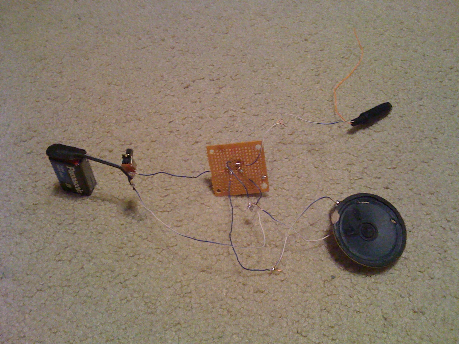

The 470uF capacitor helped alot. But I think it is the copper wire, because when I touch a 10uF capacitor between pins 1 and 8, even without any imput connected, I hear a lot of static and I can clearly hear a man talking, but can barely make out what he is saying.
The reason I used this insulated copper wire is because it is easy to solder for my inexperience, but I guess I'm going to have to find some real wire.
EDIT: But some people are saying it isn't the copper wire...???
Here is a picture of it...
As far as I could tell from your previous post, TheNewGuy, you haven't conected the ground of your input to the ground of your amplifier, right?
Your speaker is small and does not have an enclosure so it will produce no bass frequencies.
You act both as an antenna and as a capacitor to ground when you touch the circuit. We, humans, contrary to popular belief, are great conductors. Strange things happen when you touch a circuit that's not properly grounded.
Still, you said that you were only conecting one pin from your audio source. That's ok, you want a mono output. But are you connecting the ground of the audio jack to the minus pin of the battery??
Bingo! It worked! No more radio!
But still no bass, I think it is the enclosure also. I have a 1,000uF 35v Capacitor (same voltage as the 470uF Capacitor hooked up), will I get less distortion and better bass (compared to the youtube video posted above?) with it? The audio comming out of it is still distorted.
I can take a video of it if you guys want...

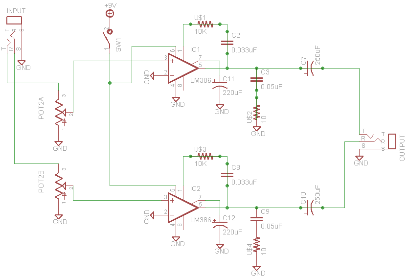

Hey Everyone,
Sorry for all the questions.... :(
How would I go about adding a couple of LED's to this schematic to make them a VU Meter (like this one) on a breadboard? (I'm going to radioshack today to get a breadboard).
EDIT: Almost forgot to attach the schematic :p
Use an LM3915 or LM3916 IC to drive 10 LEDs in a VU meter.
adding another LM386 IC or two to your amplifier can drive a couple of LEDs and make them blink to the beat of the music.
