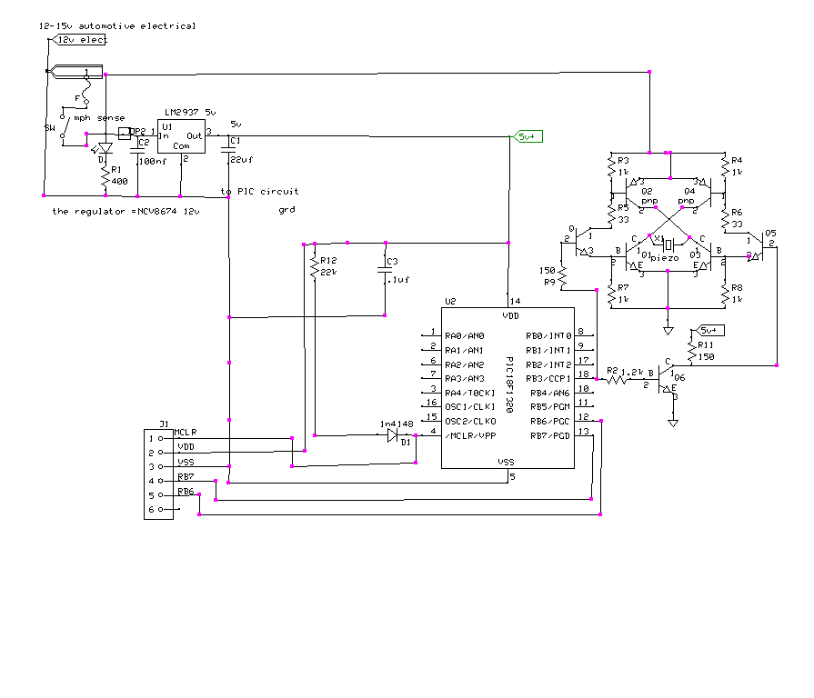

The dang deer were no where to be found . Maybe due to time of day etc. I had to turn off after 20 minutes as the TO-22 pkg transistors got really warm.
Thinking I should either just add heat sinks and/or change to a TO-3 package. Add some heat sinks.
Change the base resistors to be equal. Audio guru recommends 270. To be conservative I'm thinking 330 -400 ohm. Don't want to drive the PIC into oblivion.
For now just add some heat sinks to the to-220 's
Then go out looking for more deer. The cattle looked up, horses didn't seem to have any reaction.
using TIP 31 and TIP 42 transistors. Pretty sure I can bolt a strip of aluminum to connect all together as tabs are isolated?. Need to verify before.

Shouldn't affect performance by using 350-400 ohms on the PIC to the 2n2222"s. Will just get the two the same resistance.
Reason I changed from 150 to 300 was current draw on the PIC output. 30ma vers 16ma,(thinking of going down to 10ma draw(400ohm)

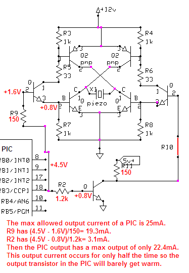

The TO-220 output transistors should not get hot if they have enough base current because they are switches, not linear amplifiers.
They produce a square-wave, not a sine-wave.
When they turn on their current is high but the voltage across them is low so their heating is low.
When they turn off the voltage across them is high but their current is zero so they do not heat.
I corrected your schematic and added voltages when the PIC output current is high.

Stupid but just got to ask?
R9 has 4.5v - 1.6v. am assuming the 1.6v is the drop across the resistor?
same goes for R 2
math is not my best subject.
Dim light in Idaho
Yes.
One end of R9 at the output of the PIC is at about +4.5V and the other end is at the base of an NPN transistor at about +1.6V so the resistor has the difference across it.
same goes for R2
Yes again.
One end of R2 at the output of the PIC is at about +4.5V and the other end is at the base of an NPN transistor at about +0.8V so the resistor has the difference across it.
These resistors limit the current from the output of the PIC.

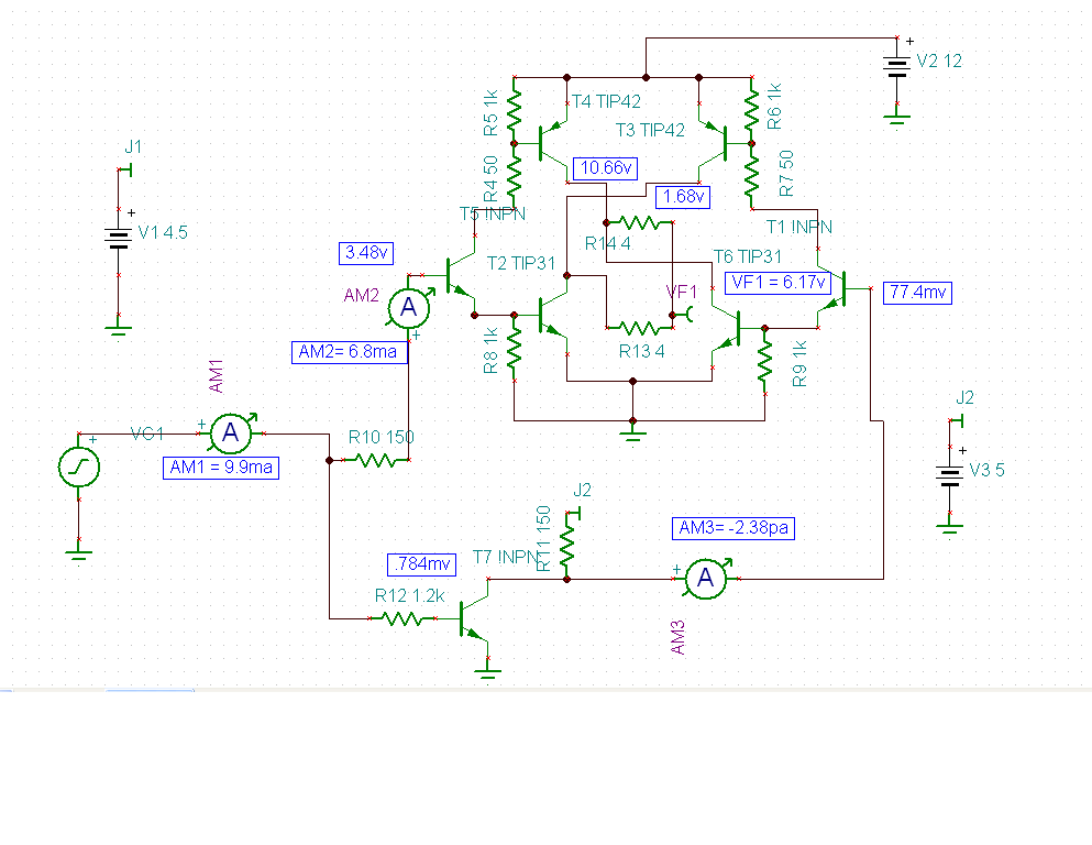

TINA simulation BUT??
current draw is not what I expected on T7 to T! = -2.38pa
Must be a simulation issue.
Input is 10khz
You were close on most everything else.
My plan is to place tweeters in a box to muffle the sound then measure voltages in real time.
NOTE the R4&,R7 (R%&6 in your posted schematic are 50 ohm instead of 33ohm)
This shouldn't be an issue as I have lots of 50 ohm resistors on hand buit couldn't find 33 ohm.
It is correct. The inverter transistor T7 is turned on so it turns off the entire right side of the H-bridge. The entire left side of the H-bridge is turned on and draws current. When the input signal goes low then the inverter turns off, the entire right side of the H-bridge turns on and the entire left side turns off.
Your simulation shows +3.48V at the base of T2 and +10.66V at the collector of T4 which are very wrong.
The base of T2 is two base-emitter voltage drops above 0V which is about +1.6V to +1.8V.
The collector of T4 should be about +11.5V since T2 and R4 turn it on very well for it to supply about 1.4A to the 8 ohm load.
The voltages and currents will be different when the low current piezo tweeters replace the 8 ohm load.

Supposly by changing the R9 (your schematic) to a 150 ohm, changing R2 from 2.7k to 1.2kand eliminating R10 (150 ohm) the transistors shouldn't get warm?
updated schematic
To avoid confusion here is the updated schematic
I used 33 ohms so that the output transistors have enough base current to drive a 3A motor. An 8 ohm speaker has a peak current of only 11V/8 ohms= 1.4A so the 33 ohm resistors can be as high as 68 ohms. 50 ohms is not a standard value but can be used. The 33 ohm resistors dissipate about 1.5W each so 2W resistors should be used. 50 ohm resistors dissipate 1W each so 2W resistors should also be used.
The transistors work fairly hard and there is a moment when both sides of the h-bridge are turned on so they short circuit the supply for the moment with a very high current.
The TIP31 and TIP42 transistors are fairly slow so that they ramp instead of switching quickly which creates some heat. The "ramping" also increases the amount of time that both sides of the h-bridge short-circuit the supply.
