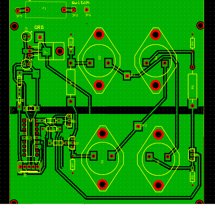

pc board layout using TO-3
here is my pc board design using the TO-3 package transistors
Will still install a heat sink as the board is only 1 oz (2 oz if the design fits my 2oz copper boards

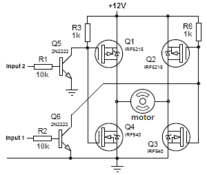

Havn't done any work using Mosfets but I understand they are superior over transistors.
Would two P channel and two N channel Mosfets work more efficiently than the four transistors in this amp??
Mosfets conduct so well that the speakers will get the entire supply voltage and the mosfets will get barely warm.
They aren't 'superior', they have some advantages, and some disadvantages - as shown by the fact that they are still VERY much a minority.
So then the mosfets would be a better choice over the transistors being that the mosfets won't get warm??
schematic is pretty much the same maybe I will make changes? for a more efficient amp in that the mosfet amp won't generate any heat. HEAT is in a sense wasted energy.
MrDEB, everything generates some heat. If you can live with a square wave a fast Mosfet will generate very little, if and only if it's driven properly.
Heat, in this case (and most others) is ENTIRELY wasted energy.
Correctly designed systems, either MOSFET or bipolar, will minimise excess heat - but there's no 'magic' using MOSFET's - and certainly commercially MOSFET's have proven more expensive and less reliable in SMPSU's and LOPT stages, and they don't run any cooler.
This square-wave H-bridge circuit is not a linear amplifier. The Mosfets switch with much more efficiency than bipolar transistors.

WHY no criss cross?
Hope I crossed ref the mosfets correctly but why are the outputs from the P channel not criss crossed like the transistor version?
And then in your schematic you show 10K base resistors for the 2n2222's
need to add??

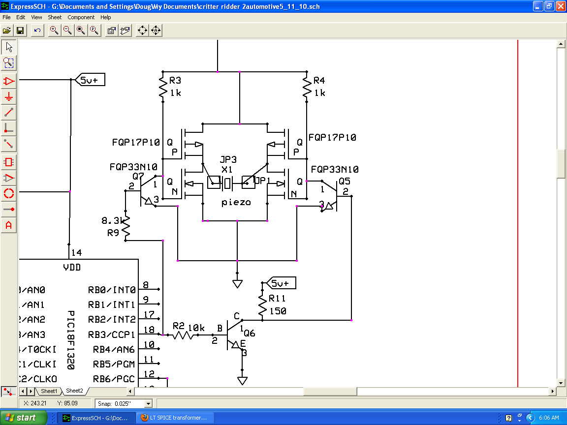

link to selected mosfets.
I have NEVER worked with Mosfets
https://www.mouser.com/Search/ProductDetail.aspx?R=FQP17P10virtualkey51210000virtualkey512-FQP17P10
https://www.mouser.com/Search/ProductDetail.aspx?R=FQP33N10virtualkey51210000virtualkey512-FQP33N10
this version should run cooler?
Those Mosfets might cost more than others because their max voltage is 100V. Mosfets rated at 30V might cost less.
The 2N2222 or any other little NPN transistor has a load of only 12mA in your circuit so it needs a base current of only 1.2mA. Then the base resistor can be 3.3k ohms.
The 1.2k resistor can be 10k or 33k.
Something like this?
And why are the outputs not cris crossed like the transistor version.
Will look at different Mosfets. I selected ones that were similar to the IRF6215 / IRF540 as in the schematic you posted.
QUESTION concerning base current of the 2n2222. Is not the load the same on both ( even though the 150 ohm (R11 is there)?
I just noticed that your P-channel Mosfets are upside-down. The sources must be at the positive supply, not at the speaker.
The input of a Mosfet draws no current, but a signal must quickly charge its input capacitance for a moment. Therefore the 2N2222 or any other little NPN transistor has no load and its collector resistor can be much higher than 150 ohms and its base current can be much lower.
R9 and R11 can be 3.3k ohms.
