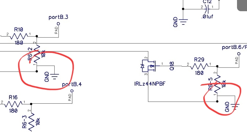

Checking the net list only verifies the board connections match the schematic, not that the connections are proper. Take time to perfect the schematic before laying out a board.
For example, these ground connections appear not to be made. You have a number a number of identical blocks. Draw one. Make it neat and clean, no jaggy lines or lines across components, and verify every connection. Then duplicate it however many times you need to.
You are almost certainly wrong, the connections look sound - just very poorly drawn. The line from ground goes UP, LEFT, and then DOWN to connect to the connection 'dot' at the bottom of the resistor. If it wasn't making proper contact, the line would vanish leaving it obviously not connected.
What he needs to do is pull the Gnd symbols down a bit, and then drag the horizontal line down until it's in-line with the source of the FET's. Same with the other badly drawn connections.
Ground connections are missing on the circuit board, yet the net list matches. So you explain how that happens.
But I greatly appreciate your feedback, even though you missed the point of starting with a clear, concise, verified and double-checked schematic before laying out a board.

All of the lines shown in pick should be ground lines. This isn't every ground line but it does include significant traces to the MOSFETs that may be handing 2 amps or more each. I defy you to find any trace between some of these segments, and there are no traces on the board that will handle 2 amps or more. If the board agrees with the netlist, the netlist is deficient. If the schematic is incorrect, the board built in accordance with its netlist will be incorrect. A clear, neat uncluttered schematic is the first step.
Additionally, there's a resistor pad marked in orange without a connection.
I'm not trying to be argumentative; I'm trying to explain problems and ways to build a better circuit board. Not that it will be heeded.
If a ground plane was used, that eliminates (potentially) the ground issue. But the +12v traces still need to carry large currents, These "fuseable link" traces certainly aren't up to the task.
