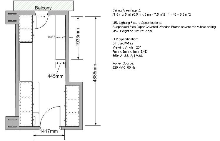

These are the LED's I'm planning to order.
I don't know where to start with the circuit design besides the fact that I will be using inverted LED's in parallel to benefit from each half cycle and the whole fixture will be controlled with a rotary dimmer.
How many power LED's will be enough to light up a room of this size behind a rice paper light diffuser? Will I have overheating problems? Any safety issues i should look into? Any ideas about the circuit design?

You'll probably need 20 to light a whole room.
Connecting LEDs in parallel isn't a good idea, perhaps yould should consider connecting them in series?
1W in an LED is probably 4 to 5 W in an incandescent.
Lighting load estimate from the NEC is roughly 15A at 120V for each 600 sq.ft.

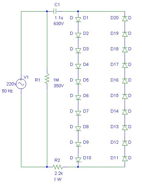

also here is what I mean by my series-parallel mambo-jambo in the first post.

could you give me an estimate of many 1 W diffused LED's it will take to light up a 6.5m² or 70 ft² room?
15A at 120V = 1800w for 600 sq. ft. = 3w/sq.ft..
Incandescents for 70 sq. ft. = 3x70=210w.
210w/4 = 50w for LEDs.
If you want special effects you might want to peek into one of those 800 page lighting handbooks you find in bookstores. It can get pretty complex.

For your posted circuit, if you give me the tolerances on the AC voltage, LED voltage, cap value and resistor value, I can probably tell you the expected brightness variation for your LED circuit.
LEDs prefer constant current, and your design seems to pretty much fly in the face of that guideline. :(

LEDs are 75 mA, 3.8 V
220Vac scares me[/QUOTE]
I don't have a lot of hands on experience with this but my first thought is
that across R2 you have ( 220 - 10*3.8 ) volts = 182
Power = (V^2 / R2 ) = 182^2 / 2.2K = 15W so I think R2 gets fried.
Also I don't think your LEDs can withstand the reverse voltage.

Is this circuit for 20 75mA 1W LED's safe?
Any values I should change?
How can I implement a heat related circuit breaker?
I suspect that circuit is safe but probably wouldn't pass UL muster.
Another point about the circuit you posted - it's a waste of LEDs since only half will be on at any one time. You are much better off building a constant current power supply. There are numerous chips made to drive LEDs for lighting -natsemi, linear, maxim, ... I'd design in blocks of 4-8 LEDs. Modular is a good way to go.
The problem with a heat related breaker is you will need to have one next to each LED. The manufacturer's datasheet should tell you a lot about thermal engineering for the part.

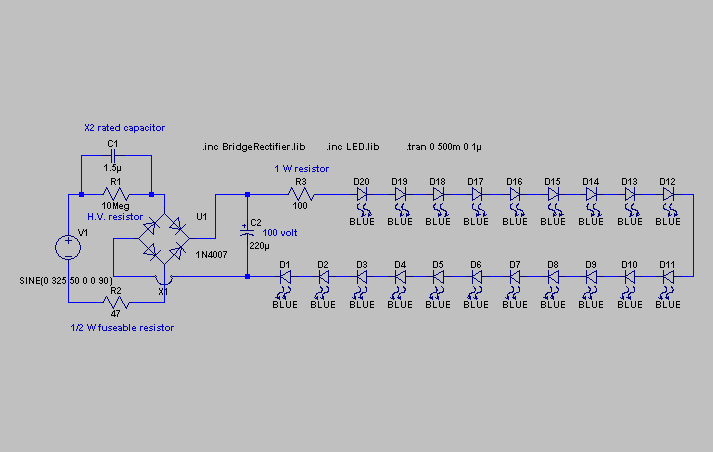

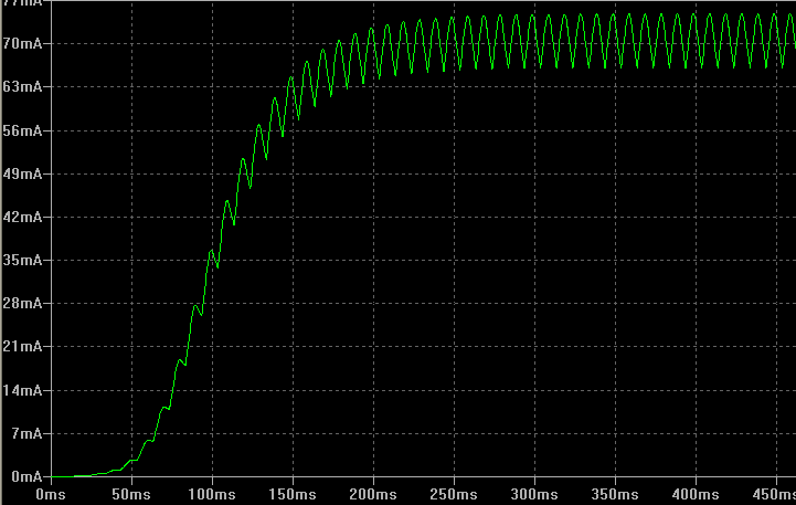

Hi Transistance,
Although the circuit will work the blinking of the leds at a
rate of 50 hurts will drive you, me and everyone else nuts.
I think you should "fry" something else.
on1aag.
