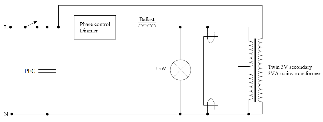

I've heard that it's even possible to make your own flurocent lamp dimmer without even doing any soldering. I'll post a schematic and hopefully a link if I can find it.

Here's a circuit for a fluroscent lamp dimmer. I haven't tried it so I don't know if it works.
The power factor correction capacitor mustn't be after the dimmer or it will blow the TRIAC.
You also need as switch before the circuit to turn off the transformer or it will remain on wasting energy and shortening the life of the tubes.
