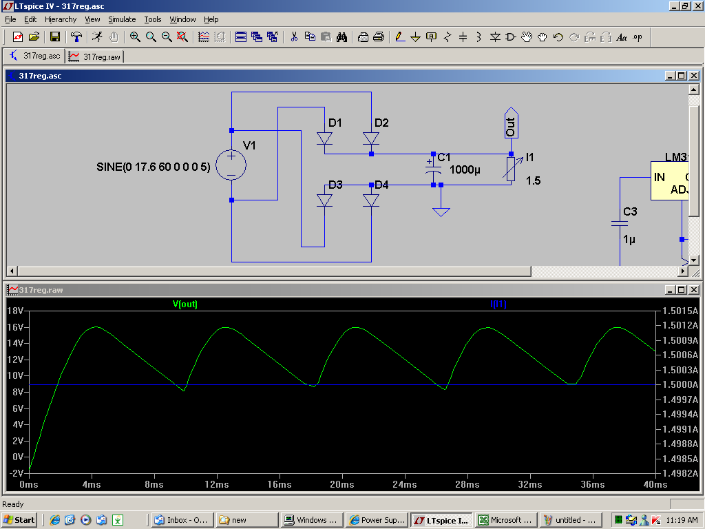

You may have seen my previous post regarding the Power supply I'm working on. I've thought about it and have decided it wasn't a lost cause... So now I've been trying to come up with a design that will work with the parts I have already bought. My transformer has a center tap on it which will give me 12.5 V or so at a maximum of 3A (the fuse will blow with any more... I think)
So here is my new design:
I'm don't know much more about AC other than it alternates in a sine wave pattern... So, will this work. My idea is, is that a DPDT switch will select the 25V or the 12V transformer output and the corresponding resistor needed to get the correct voltage range.
First, will my idea of using the center tap(12V)/normal(25V) selector work to get 2 different input voltages to the rectifier. And how much will my capacitor up the voltage. Something I read about the center tap being 180 degrees out of phase... I don't really know what that means or how that would effect my design. Even if it would not work, can I buy some type of transformer with two different output voltages? Something someone suggested in my previous thread.
Second, will my idea of using the DPDT switch to select the voltage and the corresponding resistor work?
Third, output amperage? This was the problem in my first design. There was too much voltage dropped at 1.5A when the regulator was set to 1.5 volts that the heat coming off the regulator was not practical to try and dissipate with any heat sink. So, I'm thinking that 1A or 0.75A is all I would need. So, how would I create such limitation? Where would I need resistors, what resistance, what wattage rating. Also, how do I calculate those for future reference?

With your 25VAC transformer the input of the LM317 will be 33.4VDC.
With the center-tap 12.5VAC the input of the LM317 will be 15.7VDC.
The input of the LM317 must be 2V or more higher than its output voltage.
It limits the current to 1.5A to 3.4A if its input to output voltage is 15V or less.
It limits the current to only 0.3A to maybe 0.5A if the input to output voltage is 40V.
If you want to adjust the current then you will need many more parts.

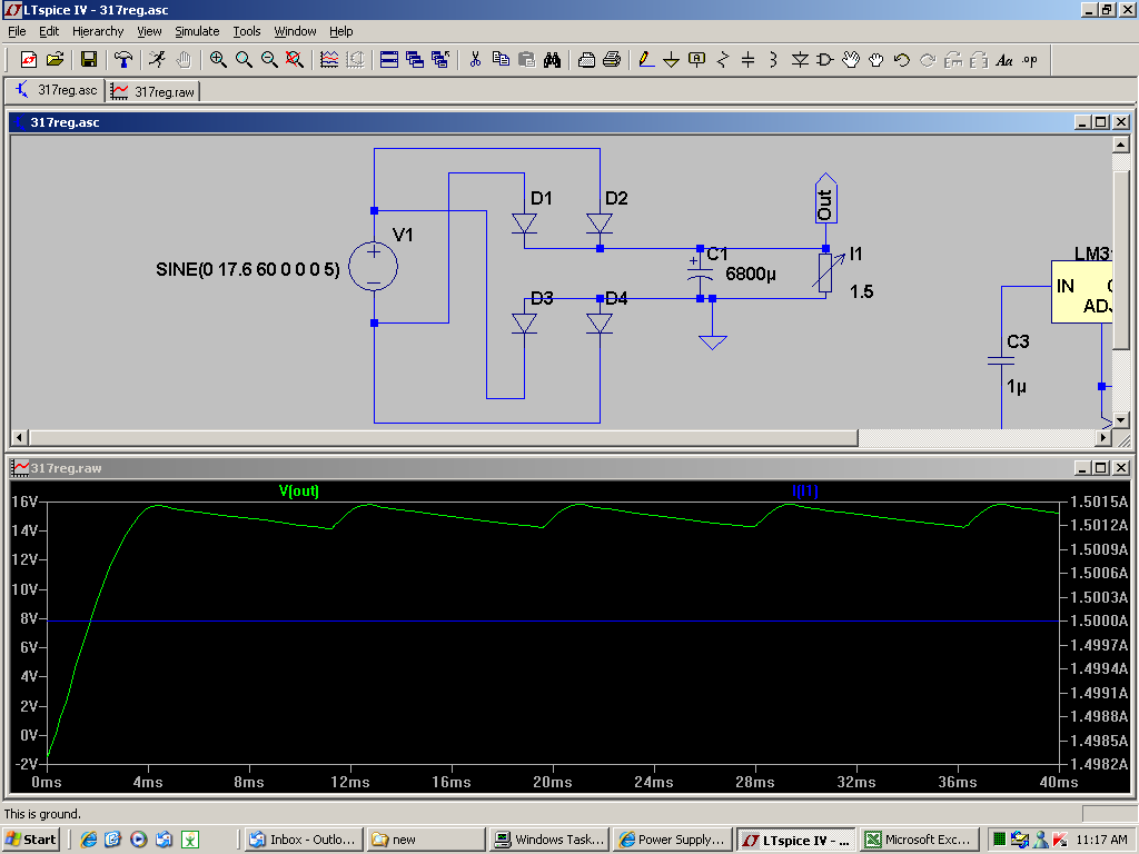

I think you need a bigger filter cap to be happy. Below shows the ripple at 1.5 amp load with 1000ufd. and 6800 ufd.. You need to allow 2.5 volts for the regulator so 6800 ufd. would let you get to 12 volts on the low tap at 1.5 amps. Now for the second part: Don't worry to much about the current limit, the IC has built in thermal protection, so if it gets to hot it will shut down. Look up the data sheet there will be some info there. So how much current can you expect? Well it depends on if you use a heatsink. The part in free air can dissipate about 2.5 watts. Now mind you this puts the junction at 150C. (50 degrees C per watt) So with no heatsink you have about 15 volts into the regulator and 12 volts out so it can supply .8 amp maximum. .8 amp X 3 volts = 2.4 watts. Using the same math at 6 volts out you can supply .2 amps at 25C ambient. Not enough I bet. So add a heatsink, lets ay 6 degree C per watt. Now you have to look at thermal resistance junction to case. For the TO-220 part this is 5C per watt. Add this to the 6C for the heatsink and you have 11C per watt.
Now your cooking! You can dissipate 11 watts. Now you can get full capacity at 12 volts and about 1.2 amps at 6 volts. A better heatsink or a fan and you can get more at the lower voltages. The same ratios will apply with the high side switch. Full output at about 24 volts and less as you go down to 12.

OK, so a bigger cap you say? Alright, you convinced me with the simulation.

As mentioned, you need a lot larger filter cap then 1000 uF for amperage you are trying for.
