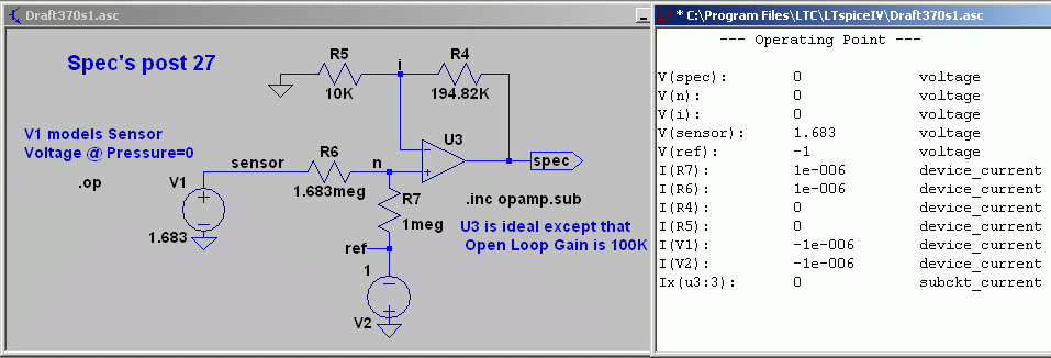

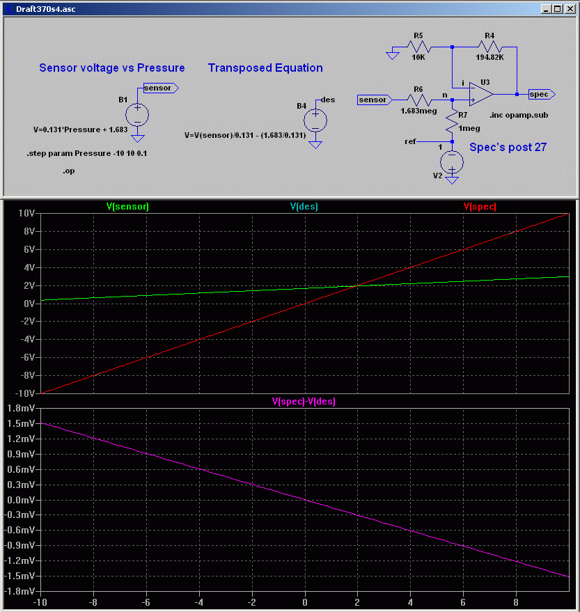

Mike, your simulation of circuit #27 is incorrect. For example, at the zero point the simulator shows an output error of 9mV ...
If a perfect opamp were assumed, there would be absolutely no offset error. How a simulator can say anything else throws doubt on the simulator or the implementation. And how you can't see this by a cursory inspection of the circuit is surprising.

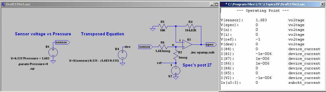

You are right. Your R6 and R7 form a voltage divider such that the voltage at V(n) (the inverting input) is exactly zero V. Since I am using LTSpice's "ideal" opamp (notice it has no part number designator, and no power supply connections), the opamp forces V(i) to be zero as well. Since in an ideal opamp, the bias currents and input offsets are zero, then V(spec) obviously has to be zero, as well. Notice that this does not validate the "gain" of the circuit; only the "offset".
Here is the LTSpice .DC solution confirming this. Be aware I am posting only a "thumbnail"; you have to click on the image below to make it open in its own browser tab at a scale where you can read it.
So why does this sim show a perfect zero V output, while the previous one showed an "error". Well, the answer is that in the previous sim, I plotted the difference of two node voltages. V(spec) was zero, but the 9mV offset was actually in the expression where I computed V(des) = 7.63*V(sensor) - 12.85. I allowed some round-off error in the transposed equation, and that accounts for the 9mV offset. Here is the sim again, this time I wrote the transposed equation so that LTSpice computes the coefficients to its full floating point precision (no round off), instead of me doing it on a calculator. The simulator did exactly what I asked it to...
So back to the "gain" validation. Here the sim again, this time I asking the simulator to evaluate the "better" transposed equation, as well as asking it to compute V(spec) as a function of the parameter "Pressure". In the upper pane, I plot V(sensor), V(des), and V(spec). Within the screen pixel resolution, V(spec) falls on top of V(des), so it appears ok. In the lower plot pane, I plot the difference between V(spec) and V(des), and now we see a slight difference.

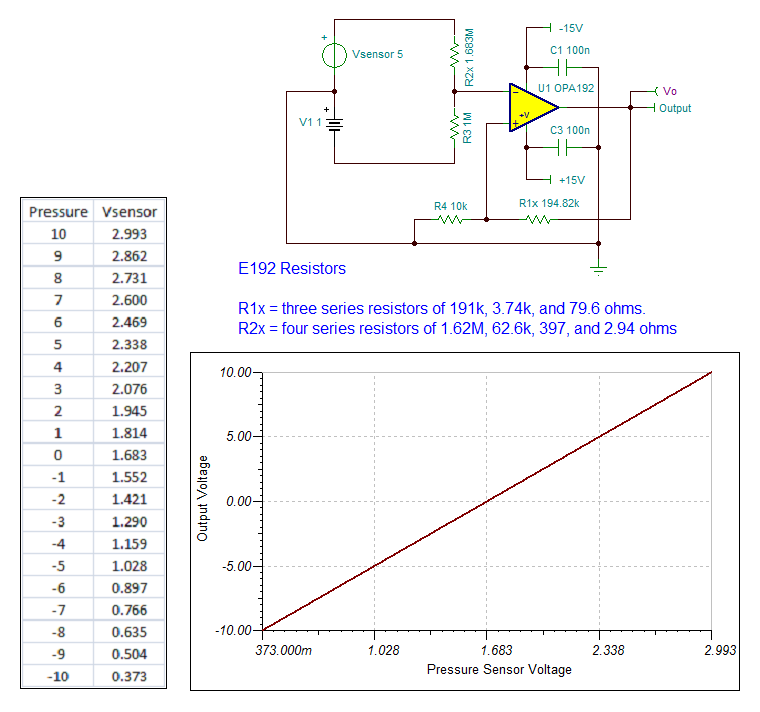

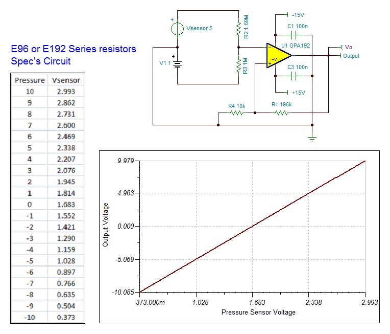

Here's Spec's circuit using the OPA model from TI.
Of course, if I wanted to get the resistance to match closer to Spec's using series resistance to get the closest I can .... Here's that circuit

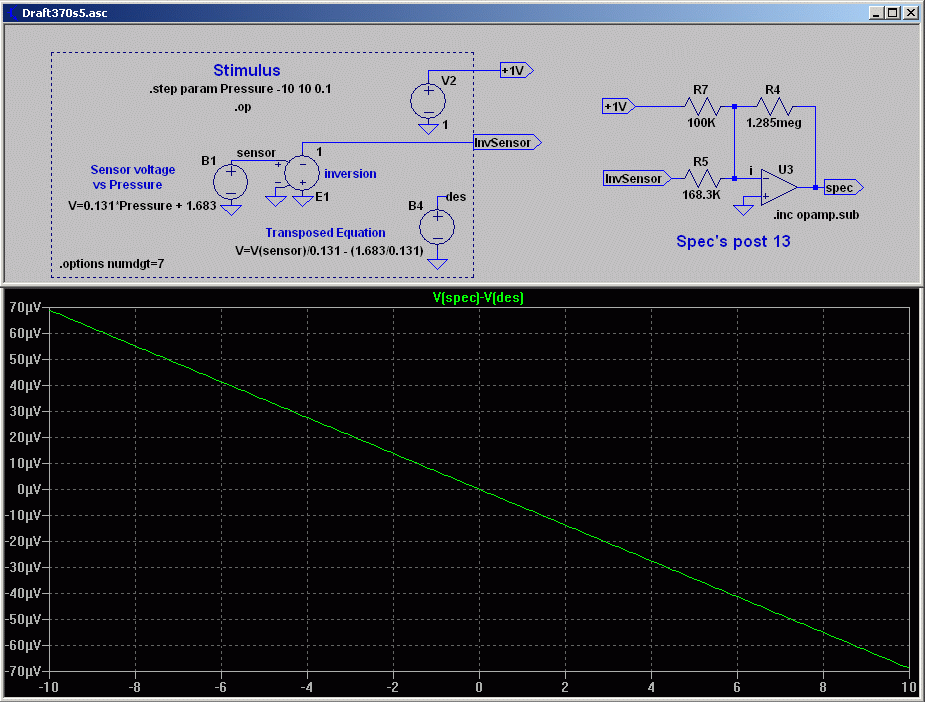

Could I impose on you and, if you have some available time, do a run on circuit #13.
spec
Here is a comparison of Spec's circuit in post 13 with the "better" Transposed equation:
