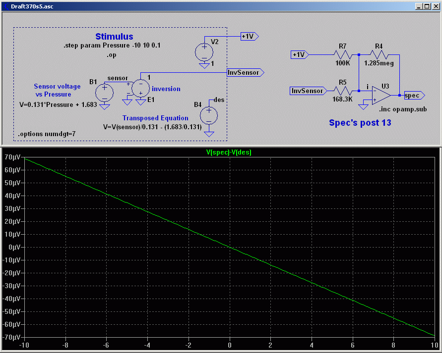

No, the TS said that he could not open a .asc file which is what I posted after he posted an LTSpice schematic. Because he posted output from LTSpice, I assumed he could open a ready-to-sim .asc file. Apparently, he was away from the computer that could open that type of file, so I posted a screen shot of the LTSpice circuit and plots as a thumbnail.
I am curious; did you click on the thumbnail? Could you read it? I am in the habit of (almost) always posting thumbnails, not the huge in-line pictures you do, which some forum members consider bad forum etiquette. If people cannot read the image after they click on a thumbnail, I need to know that?

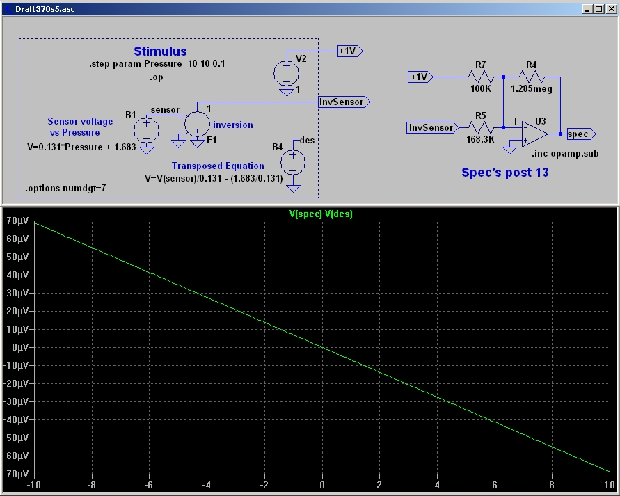

I wonder if this is a browser thing? I am using Firefox, and the thumbnails render just fine when I click on thumbnail and it opens into a new tab in the browser.
Here is the image of post #55 again. I put it in-line two ways, first as a .gif followed by a .jpg. I also put in two thumbnails, one of the .gif, and the other of the .jpg. Please look at all four, and tell me what you see...
gif full image:
thumbnail of gif:
jpg full image:
thumbnail of jpg:
gif full image:
thumbnail of gif:
jpg full image:
thumbnail of jpg:
I am using the latest Firefox.
Laptop screen: 15.6" diagonal
Resolution: 1920 by 1080 native
Both your .gif and .jpg render 220mm wide and are clear, including the text.
The gif thumbnail clicks to 140mm wide in a new tab and the text is not clear
The jpg thumbnail clicks to 190 mm wide in a new tab and the text is clearer.
I usually expand/contract an image by using Ctrl plus + or - but if I do that with either expanded thumbnails the tab closes.
I have just noticed though, that at the top right of the expanded images, in addition to a cross to close the tab, there is also an arrow which, if clicked does expand the image and improve legibility of the text.
It would be nice if your thumbnails simply expanded to display as the gif and jpg immediately.

Here ya' go ... Spec (post 13)

Given that the pressure sensor produces an output voltage (Vs : sensor output voltage) according to the equation Vs = (P x 0.131 )+ 1.683. This equation can be expressed in terms of pressure (P) versus sensor voltage (Vs). ie.
P = (Vs - 1.683)/0.131
You are to design the amplifier circuit for this sensor using any combination of inverting amplifiers, non-inverting amplifiers, summing amplifiers together with a 1V reference voltage source. The two input signals of this circuit are sensor voltage (Vs ) and an 1V reference source (Vref ) and the circuit should produce an output voltage (Vo) indicating the pressure (psi) according to the equation Vo = P (psi)
i.e When P = 0 psi , Vo = 0V and
P = 10 psi, Vo = 10V.
P = -10 psi, Vo = -10V.
