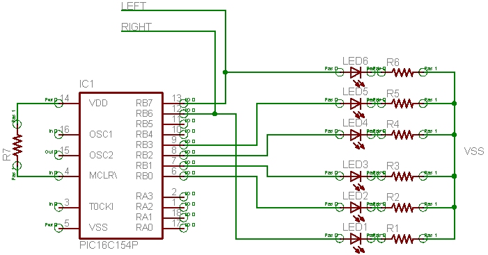

This could be breadboarded with a microprocessor. If you used LEDs as the tail lights on the breadboard it would look somthing like this. I picked a random 18 pin chp only used 8 I/O pins.
The lines LEFT and RIGHT are inputs from the autos flasher module.
On the real circuit a voltage divider and zener would be used to get a safe 5V from LEFT and RIGHT. Replace the middle and center LEDs with transistors to drive the 12V bulbs. Voltage regulation for the processor.
Code should not be difficult.

is there anyway i could delay the midle and outside lamp, just usisng resistors and capasitors ? or i really have to use a chip to drive it. like just putting a resistor and a capacitor betewen midle lamp and outside lamp so they lit up in sequence but with a litle delay from the inside and eachother. can i do that ?
If it was that easy FoMoCo would have done it int the 60's. Instead they build an expensive complex box with motors wipers and relays.
How are you going to determine when to lite the brake vrs the turn signal. With a processor you know it is the brake because power is applied to right and left at the same time.
By the time you paste enough components in to make it work you may as well have used a processor. With a processor if you goof you reprogram it.
