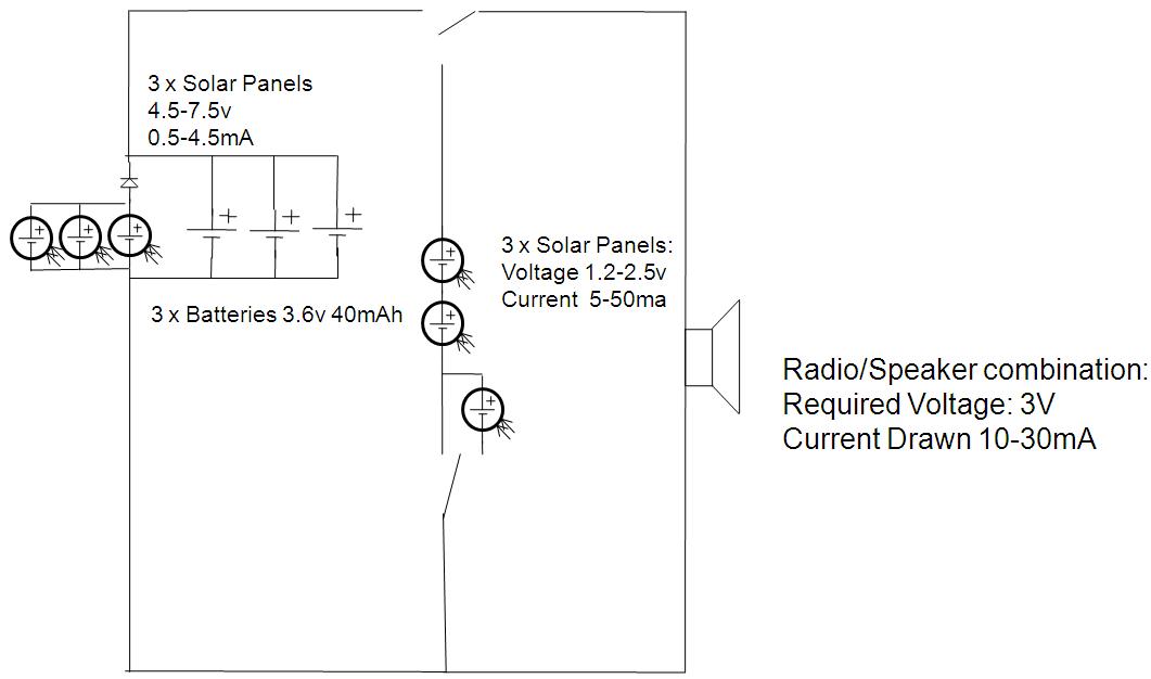

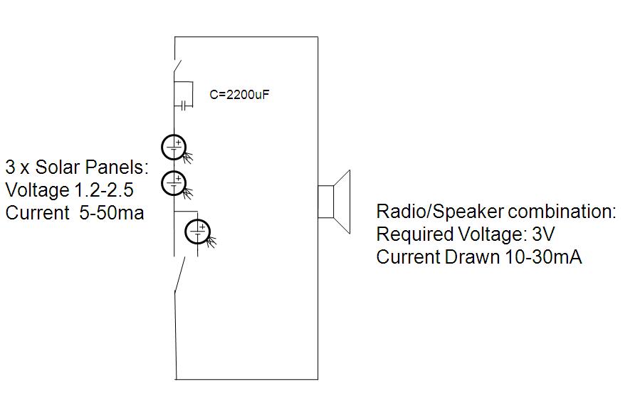

Ok Carbonzit, I've taken your advice and come up with two circuits that I'll run with the materials I have, I've attached the .Jpegs.
The Radio schematic is powering a small radio which includes an amplifier and speaker, just hooking up directly to the battery terminals. I'm using this instead of the Pringles speaker. I might hook some batteries up to it as well, but currently its just going to be powered in sunlight. Not sure if the capacitor is needed? I was thinking it might help smooth small fluctuations in sun light.

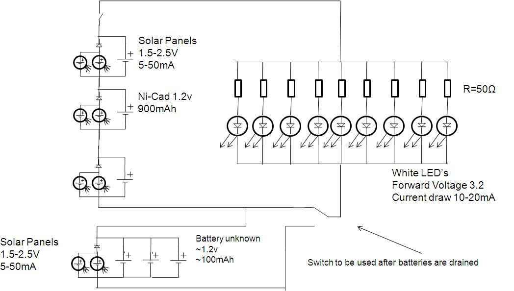

The LED schematic is powering a 9 LED light, to be used only at night. I only have 3 decent batteries totalling 3.6v in series, so I've included some worse batteries at the bottom to boost power, the switch can choose between high and low voltage (wasn't sure what the resistance of the drained batteries would be.
Any feedback/improvements would be greatly appreciated!

Your radio circuit shows both wires of the capacitor shorted together so it does nothing. It should be connected in parallel with the power supply wires of the radio.
Your LED circuit has all battery cells connected with backwards polarity.
You should learn about electronics before one of your wrongly wired circuits burns down your home.
Yeah I'll admit the capacitor error is pretty bad - I'm not sure I really need a capacitor there anyway? The Batteries I just forgot to rotate, I know which way they're supposed to be wired when doing it!

The capacitor ain't gonna buy you much; maybe a few seconds of playing time if the sun goes behind a cloud. If, as you say, this is mainly for amusement's sake, just let it fade in and out. You'd need a much bigger cap (probably a supercap) to do any real good there.
And as Audio McDuck pointed out, the capacitor goes in parallel with the batteries.
By the way, your JPEGs are a huge improvement over your PDFs!
So far as your overly-complicated solar light circuit goes, it's a real mess. Obviously you're limiting yourself here to stuff you already have on hand. But if you were designing this from the ground up, you'd want all the solar cells grouped together as one source, and all the battery cells grouped together as storage. As it is, you're trying to run heterogeneous stuff in series, which while it's not dangerous or anything, it's certainly not efficient and you'll end up throwing away precious power.
But hey, it might just work ... actually, on second look, there's a major error in your design. You have several current sources (batteries of differing capacities) placed in series. That's no good. The "stronger" cells (the ones with higher mAh ratings) will be trying to force excess current through the "weaker" ones.
You really, really want all your batteries (with the same voltage rating, obviously) to be placed in parallel to form a bank of storage. Is this so hard to do? Since you're going to all this trouble, how hard would it be to just take everything apart and reassemble it in a better configuration?

Are you talking about the LED light circuit here? I was going to run it like that so that there was 4.8V @ 20mA until the bottom batteries run out then I'd flick the switch to the left so it bypassed them. Its because I need 4.8v (ideally) to run the LED's but I don't have enough good batteries.
I would be more than happy to reassemble it, not a problem, if you let me know how it would run better?
Also I found some 4x AAA 1.2v 650mAh NiCd or even & 2x1.2v 1.5Ah batteries which could be utilised?
Sheesh, what a mess.
OK, referring to your latest drawing for the LED lighting circuit, we have, over there on the left, a series string of three solar lights:
  • 1.5-2.5V @ 5-50mA
  • 1.2V @ 900mAh
  • ??? (unknown voltage and current)
So adding all this up, we come up with a grand total of
2.7-3.7V + X @ 5-50mA
("X" being the unknown quantity)
Remember: you can add voltages in series, but not currents. Currents add in parallel.
Here's what you actually want (generalized circuit, no values):
Nice and clean. The solar cells are arranged to give you the voltage you need to supply your load and charge your batteries. The batteries are arranged so that they're all the same voltage and in parallel to sum their current.
You cannot achieve this by connecting your little solar lights together as you indicate.

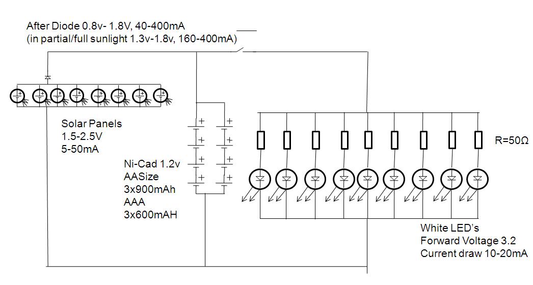

Bearing in mind I would only be powering these at night so the solar panels are purely there to charge the batteries. The idea was the batteries would run @4.8v as using around 200mA there are 4x 1.2v in series for 300mAh or until the unknown capacity batteries ran out at which point I'd throw the switch and change to run off 3.6v for the remaining 600mAh (assuming they are fully charged, which they probably won't be).
Your diagram is much nicer and I'm not using the circuit boards from the solar lights anymore, just the solar panels and batteries so I could try and rearrange it more like the schematic you supplied. So I'll have a look at desiging one with what I've got an repost.

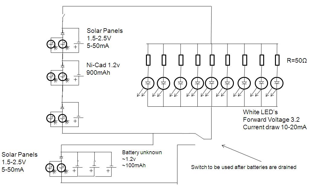

Ok here's a new schematic, only thing that concerns me is the charging of the battery, I'm not sure of the acceptable limits for NiCd charging? I've removed all the extra stuff from the solar garden light circuit board so its really what you see is what you get in this schematic.

Gravymister,
I wish you learn about voltage and current soon because your latest schematic has serious errors:
1) An old-fashioned Ni-Cad cell is 1.4V to 1.5V when fully charged. You have four in series so they should have a total of 5.6V to 6.0V.
But they will not charge when the solar panels produce only 0.8V to 1.8V after the diode. Also without a voltage higher than 3.2V the LEDs will not light.
2) If you change the circuit so it produces 6.0V then the 50 ohm current-limiting resistors for the LEDs limits the current too high at 56mA so they will burn out.
Hang on, I'm pretty sure that schematic is wrong because the charging voltage isn't high enough. I don't think with the components I have I can feasibly make a schematic similar to yours.
Basic stuff to keep in mind:
To charge a battery, you need a voltage higher than the battery voltage. You cannot charge a battery with a lower voltage.
You can achieve this by putting your solar cells (they're not really solar panels) in series/parallel, as I suggested in my schematic. Since they're only being used to charge the batteries, current is less of a concern than voltage.
Ok, I see what I did wrong audioguru, but how do I correct it? If I reduce the batteries, then I can have a max voltage post charge of 4.5v which works with the resistors.
In full sunlight though the charging voltage looks to be too high.

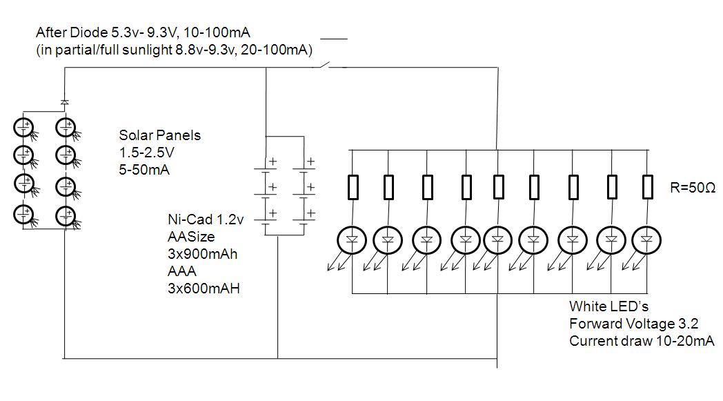

How are you figuring current for your solar array?
On your schematic, you indicate 5-50mA for the solar cells. (I ASS-U-ME that means for 1 cell?)
Up above, though, you have two current ranges, 10-100 mA and 20-100 mA. Where do you get these values from?
Remember, if you have two sources in parallel, you add their currents. In this case you have two series strings of cells in parallel, so you double their current output. So shouldn't the current be 10-100 mA?
Your LED resistors are now a little too high. Since you're "wasting" 0.4 volts (3.6-.2) @ let's say 20mA, you need a 20 ohm resistor. (You could increase it to 40 oihms if you want to limit the current to 10mA, but the LEDs then may not be bright enough.)
Regarding overcharging our batteries, keep in mind that if you're only imposing a trickle current, you don't have to worry about it. Now, I don't know exactly what would be considered trickle current for your particular nicads. I'm sure someone else here does, though.
Oh thats a typo I think, you're right its 10-100ma range. With regards to the trickle is it not 1/10C is considered a trickle so since the batteries being used are 900mAh and 600mAh trickle currents would be 60mA and 90mA and the max either would get would be 50mA so that would be ok?

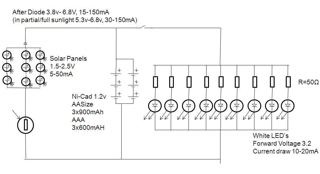

All in all though If I obtained one more solar panel, perhaps this design would be more effective? I also thought about adding an LDR so that in the evening, when the lights are not being used the LDR will block any discharge from the batterys around the circuit through the panels, I could be wrong in that assertion though.
Also, where am I wasting .4 volts?, I could use 4 batteries and have a higher R value if its cutting it too fine with too little voltage? Ideally I think I want 20mA through the LED's I would like them to be quite bright.
