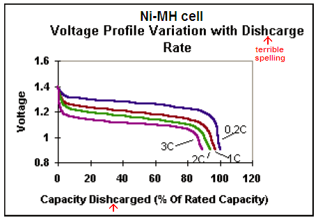

So you're saying the maximum voltage from the NiCds will be 1.5v each? I doubt they'll even get charged that much surely? As long as the voltage doesn't go above 3.9 so 1.3v per battery there won't be a problem
According to Energizer, when a Ni-Cad or Ni-MH cell is charged to only 1.3V then it is almost dead.

Are you sure??? I've always been told that 0.8V per cell is dead, and 1.2 volts is full charge for NiMH and NICAD... otherwise how would we get 6 cells batteries (7.2V) that are sold everywhere, if 1.3V means discharged???
The nominal voltage of a Ni-Cad or Ni-MH cell is 1.2V when it has a heavy load and is half-discharged. I showed that a battery manufacturer lists its fully charged voltage as 1.4V when trickle-charged and is 1.5V when strongly charged. When the battery cell's voltage is as low as 1.3V then its capacity is almost nothing.
From the same Battery Applications Manual here is a graph of the discharging voltage vs remaining capacity:

From that diagram looks as though I should use resistors of 33 or 36 ohmas the voltage will mainly be around 1.3v, I doubt very much they'll be fully charged ever by the solar panels so 1.4v won't be an issue
You don't know how high the battery cells will charge and you don't know the minimum forward voltage of the LEDs. Put the two together to see that the LEDs might burn out. So increase the value of the current-limiting resistors.
You could connect the solar panels to your battery (and its series diode) and leave it in bright sun for a few days then measure how high the battery voltage gets.
You could connect each LED to a series resistor set for 20mA and measure the actual forward voltage of each LED.
Then you will know the details and can simply calculate the value of the LED current-limiting resistors.
