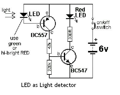

According to few reading and few experiment, I know that each and every junctions produce light (tiny amount in transistor junction, huge amount in LED) during operation. So transistors and ICs are packed by black epoxy to save from light affect. So we can get some unusual benefit from transparent LEDs or dioodes (like 1N4148).
I experimented with a green light as a light detector, shown below. How actually it works? Sure not like a LDR. I think it passed few volt and current above than 0.6V (forward voltage across the LED) so PNP conducts. Few more analysis needed.

LEDs will work as solar cells and generate current. They are quite small so not much current can be obtained, but with a high impedance voltmeter you can measure the voltage quite easily when the LED is in sunlight.
I have even lit an LED with the current generated by two others.

Hi MikMI and all,
I Read again some articals about LED light detector. Semiconductor and light has very close relation. I knew that LED creates voltage as solar cell, wow one LED is making 1.5V very easily!
My simple analysis of the circuit:
I guessed in the OP image, during focusing on light, the forward green LED creates +1.5V less than the emitter on the 'base' (probably 0.6V less than emitter?) so positive emitter of the PNP starts to conducts to the negative base. Thus it passes current through E to C to operate, isn't it?
I saw a circuit with a 8 pin micro and one LED. It made a night light. 100 times a second the LED current was turned off. After mS delay the LED voltage was measured to determine how much light was in the room. The LED both made light and detected light.
