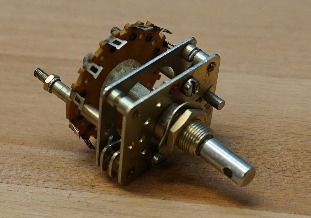

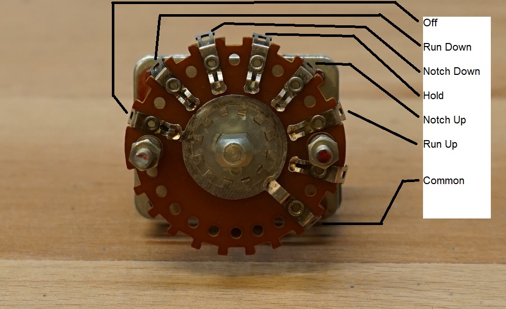

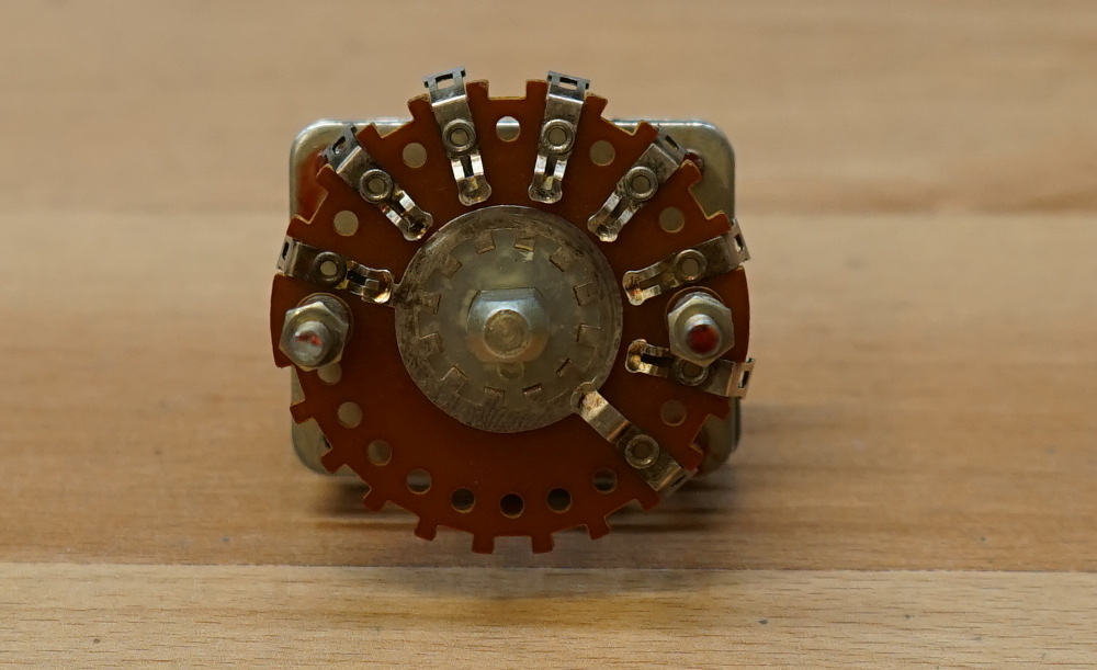

Here is my prototype modified switch:
The self centre-ing action of the HOLD position could maybe do with some improvement, but whether that could be done on a simple mechanism like this I am not sure.

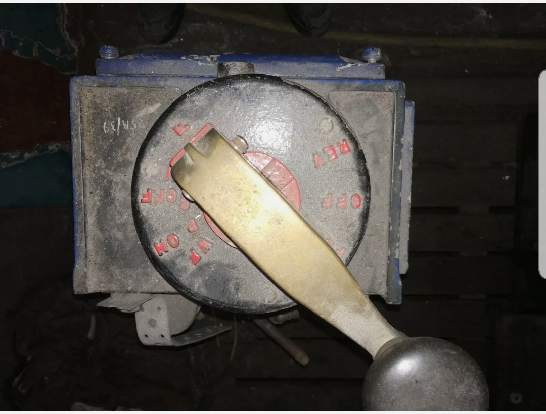

I'd guess it's some form of detent / "plunger" system but I can't say for sure... On the real thing theres a lot goes of "gubbins" under the desk...
I'm not saying that this is what the power handle controls under the desk where you can't see, but what I think is (or more than likely) is under the desk...
Eric

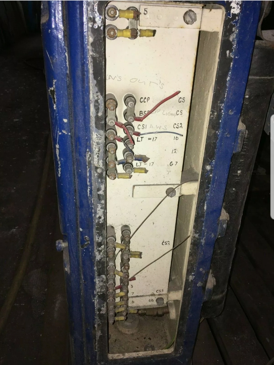

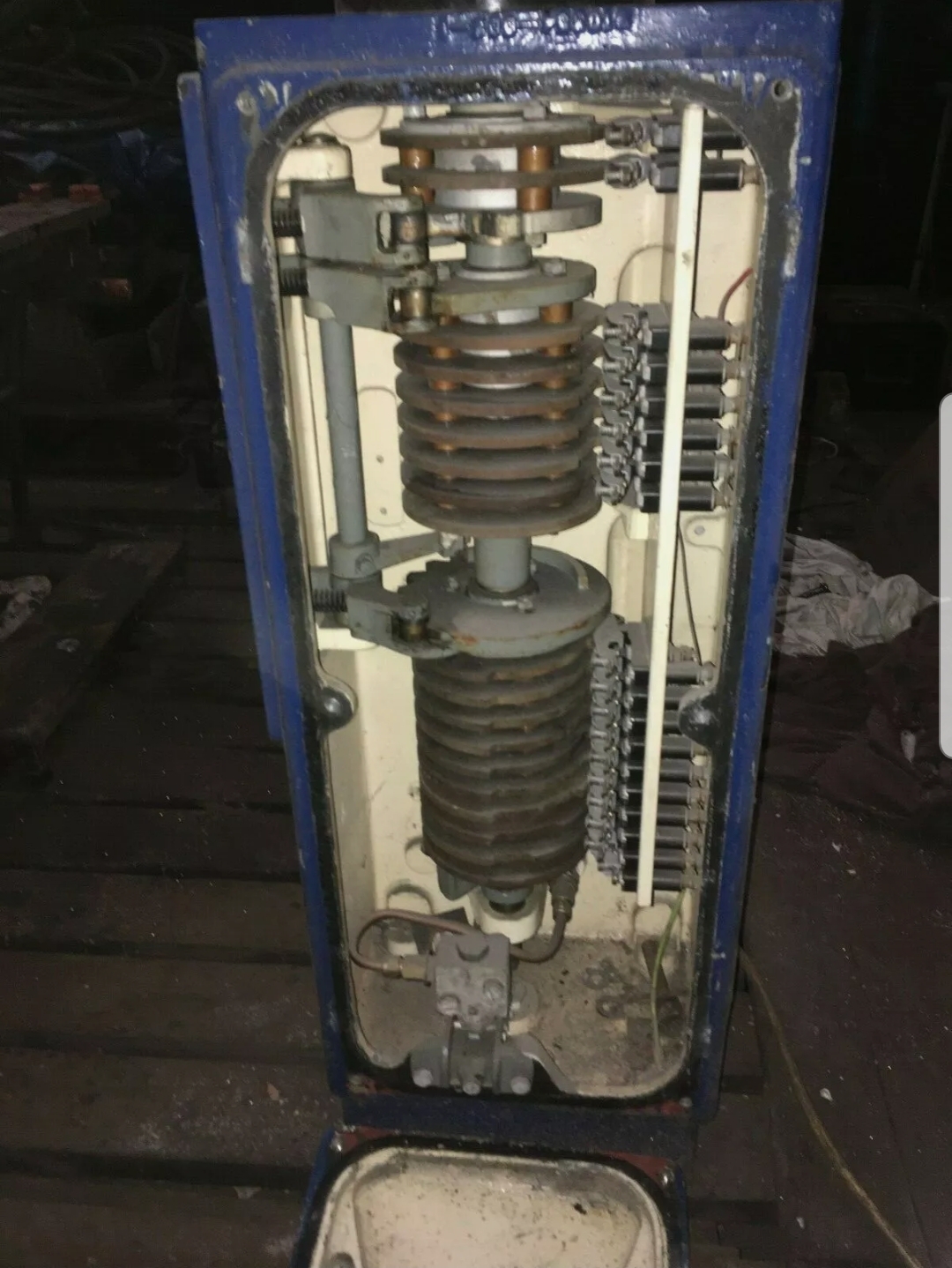

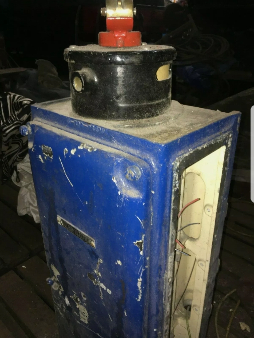

That's in principle a big "Cam switch".
It looks like the largest section at the bottom is the main "notch" section, the grey cam at the top of that has multiple small notches with the lowest roller running in them.
I'd guess the middle section is the on/off switch, with an interlock to the rear segment cam on the notch plate so it cannot release with the main one in a driving notch.
And the the top small section may be the retaining detents for "off" and run up / run down, as the recesses are much deeper than in the main notch plate.
It's similar principles to the older direct controllers I've worked on, but with smaller contacts to switch external control gear rather than the full motor current; eg. this has speed notches on the left & forward/reverse on the right. The "notch" cam & spring roller setup is just under the top plate.

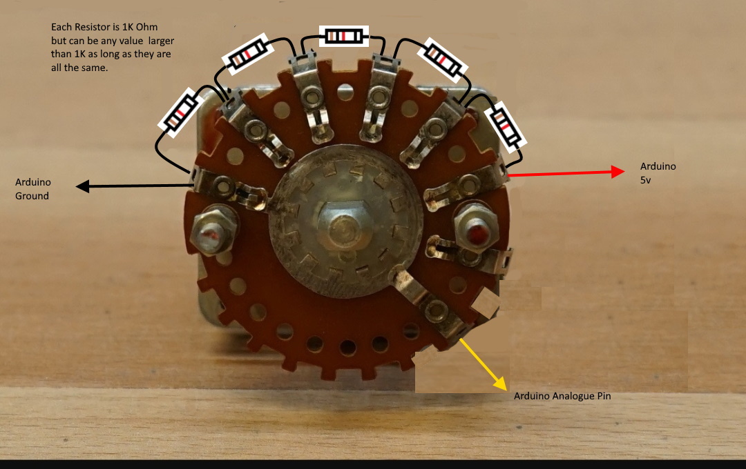

Hi Everyone, my name is Chris (CobraOne) and I am the author of the 'TS2017 Raildriver and Joystick Interface' that Eric refers to.
The software can be a little overwhelming to start with but it does allow you to create your own controllers and instruments to talk to TS2021.
With regards this project, Eric has two options that I see to connect his switch to a Arduino.
1. Connecting resistors between each contact will in effect turn it into a joystick.

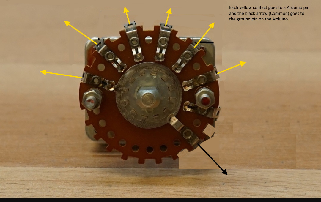

2. Connect each contact to a pin on the Arduino and
(A). Program the Arduino to send the necessary joystick position or
(B). Program the Arduino to send the keyboard commands A and D. This will negate the requirment to use of my program to talk to TS2021.
If you also wish to display data from TS regarding speed, brake pressure etc then you will need to use my program. You can display the data using LCD's, 7 segment displays or use servo's or stepper motors to create your own analogue gauges.
I am not a professional programmer or an expert on the Arduino but I believe I know enough to help anyone who wishes to use my software to create a train cab.
