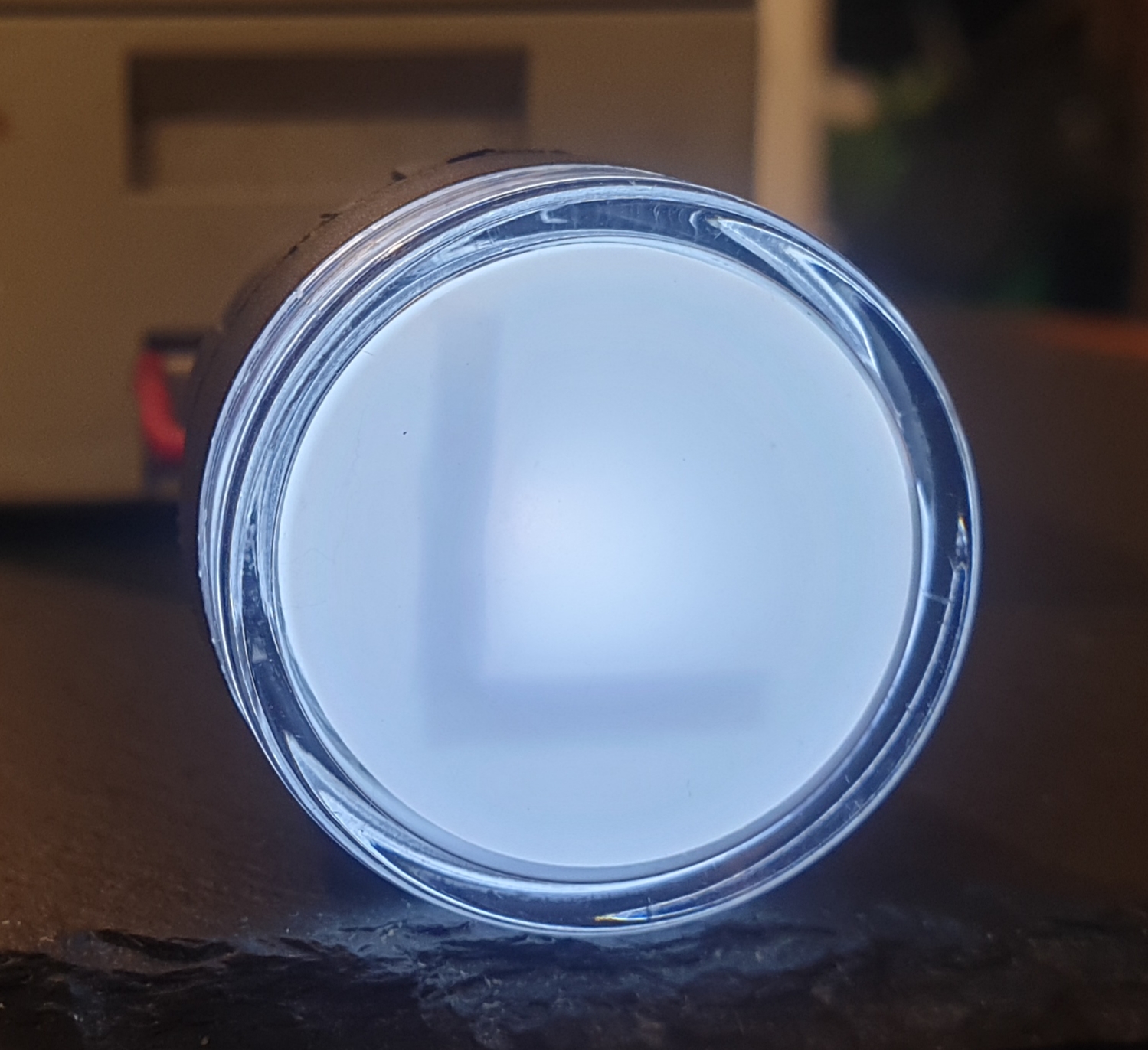

I've just obtained a "line light indicator"...
Ok... so the "L" needs modifying to make it more defined (I only had some silver gaffer tape to hand...!!!)...
Would your programme be able to control the functioning of the line light indicator???

Hi Eric
I have had a look at the 86/87's I have and only the 87 from keithmross WCML2 actually outputs the data for the line light, the 86's from RSC\Class86Pack do not.
With regards to using the light, it depends on what bulb/led is in it and what voltage it requires. If its a 12v bulb then you would need either a transistor as a switch or a relay because the Arduino only handles 5v.

It may well be on in the train but, if the designer of the loco does not design the loco to also output the data to the DLL that my program talks to, then there is no way for me to show it. That's why it works on the 87 from keithmross but not the 86 from RSC.
You have the same situation with door light on some loco's, some output the data, some don't, I have no control over that.
