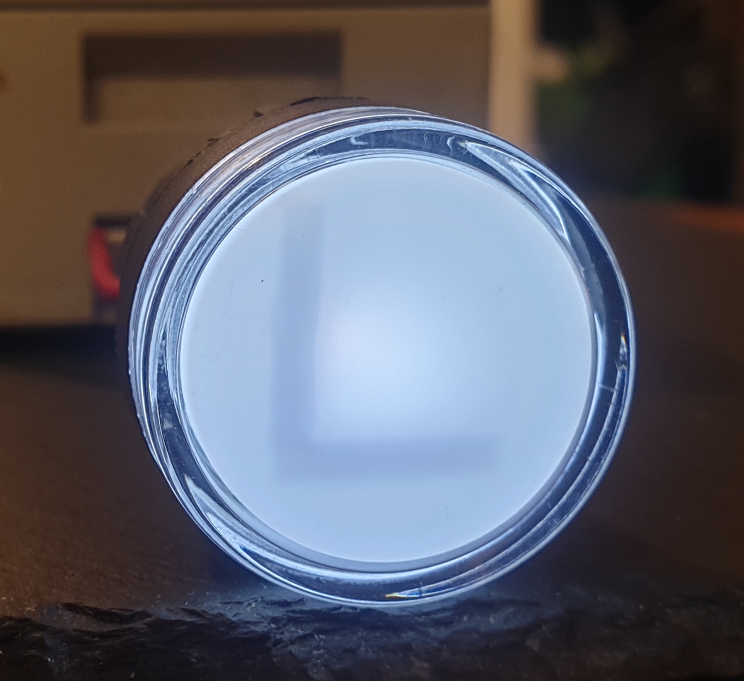

I've just obtained a "line light indicator"...
Ok... so the "L" needs modifying to make it more defined (I only had some silver gaffer tape to hand...!!!)...
Would your programme be able to control the functioning of the line light indicator???

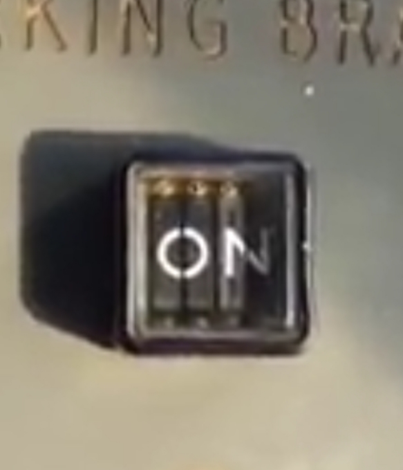

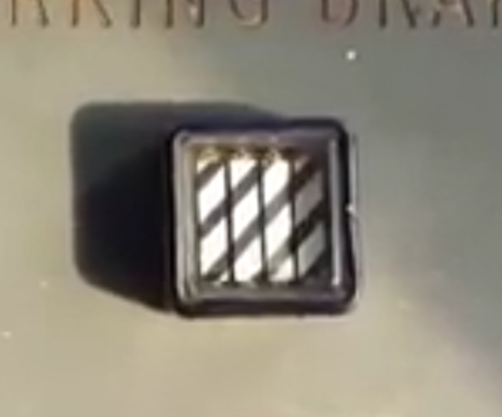

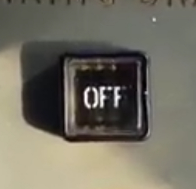

Can any of you guys please identify this "indicator" or at least its proper name / technical term...
In case you're wondering, it's the parking brake status indicator on a Class 87...
