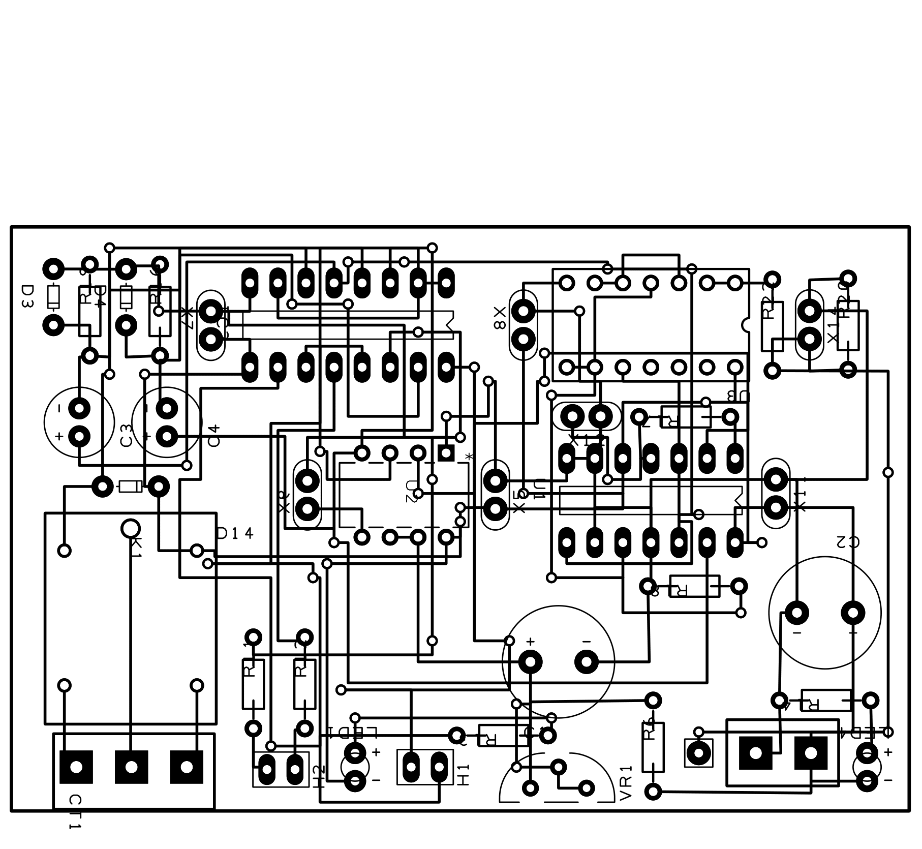

Ive managed to make the pcb but the resistor available to me is too long. Ive edited it, gave it a new name, saved it. I can see it in the manager but can't access it from the components tab. not sure how to proceed.

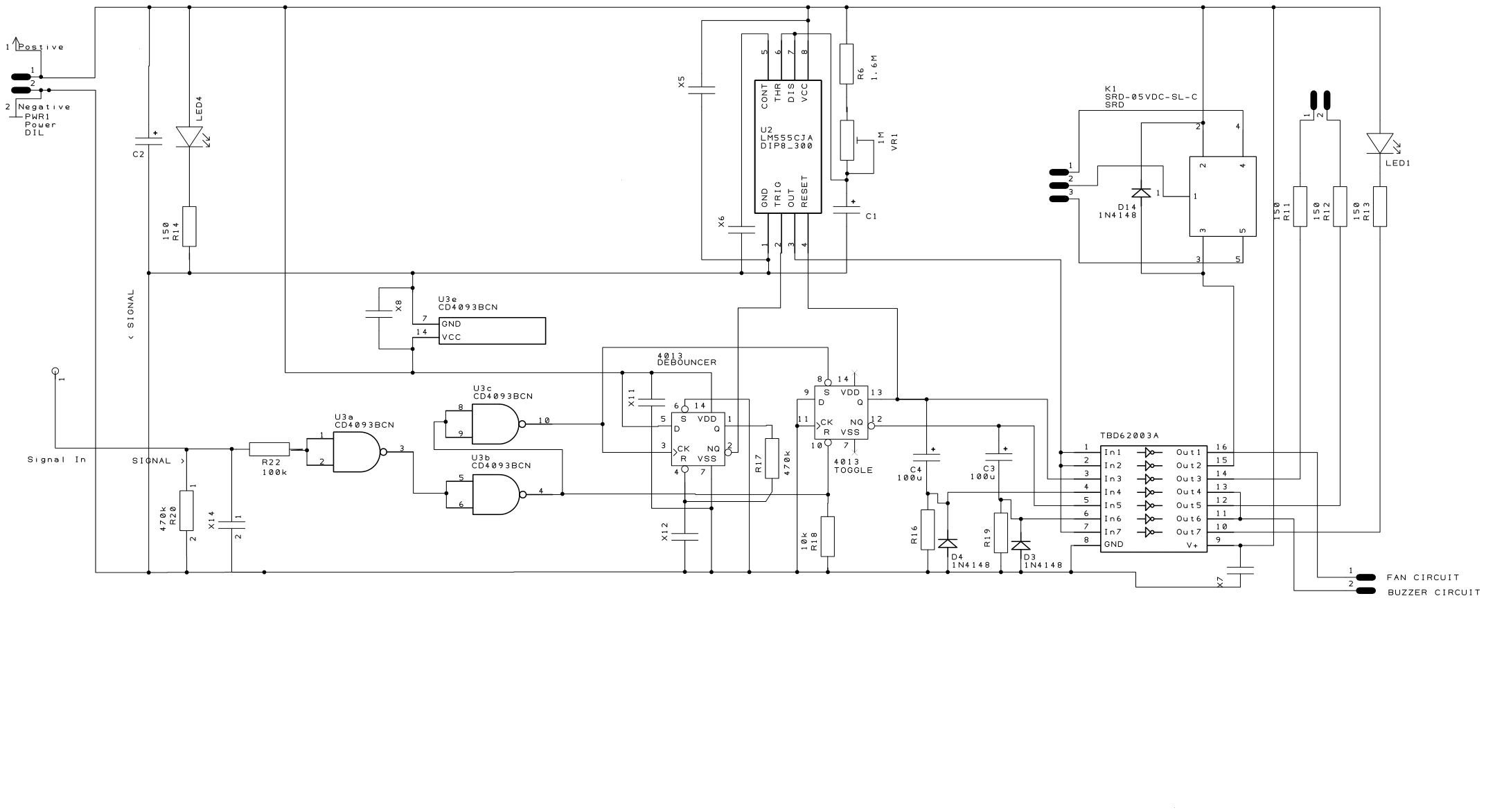

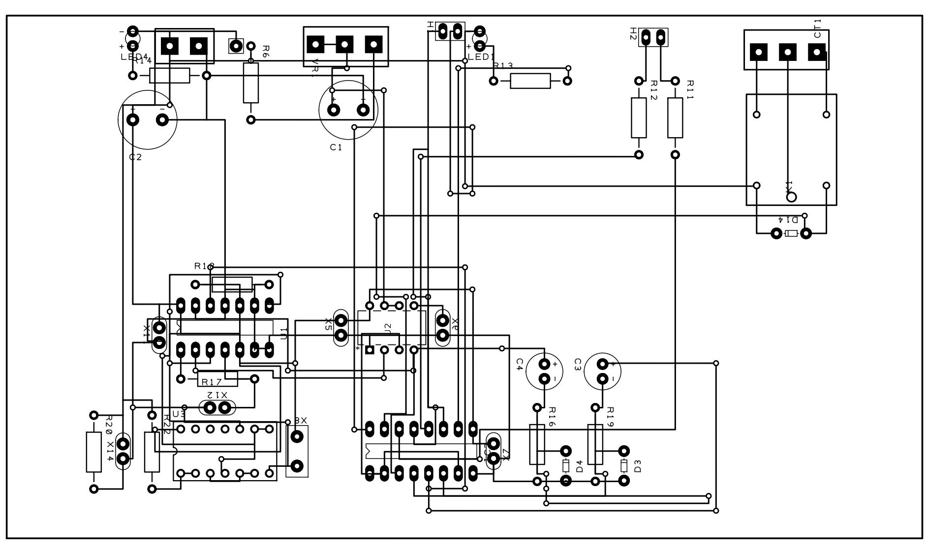

Files for project with extra circuits removed
Did you mean to you uploaded files?
Or review images?
The PCB image is not useful for review.
In the schematic, I noticed the 4013's have active low bubbles on Pre/Clr pins. The 4013's are wired correctly but, for accuracy, the bubbles on the schematic should be removed because the 4013 has active high for those pins. I think there is an exiting schematic symbol "DTYPE03" you can use.
I removed the external fan/buzzer circuit
I do not have that but I did aquire one from Loader. CD4013BEE4.
I removed the auto routing, changed the component, then re ran the auto router. It changed a bit. I think everytime i run that feature the routing is different.
You can "fix" a track (lock it in place) so that the router doesn't affect the track.
I never use the autorouter because they never do a good job of routing.:cool:

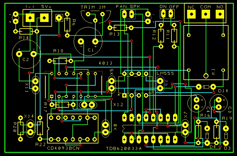

HERE is my final file. i hope. ive cleaned it up a bunch. the rule checker is upset about overlapping screens but it visually looks ok to me. Can you recommend a developer for this PCB i need 20. 50x80mm
